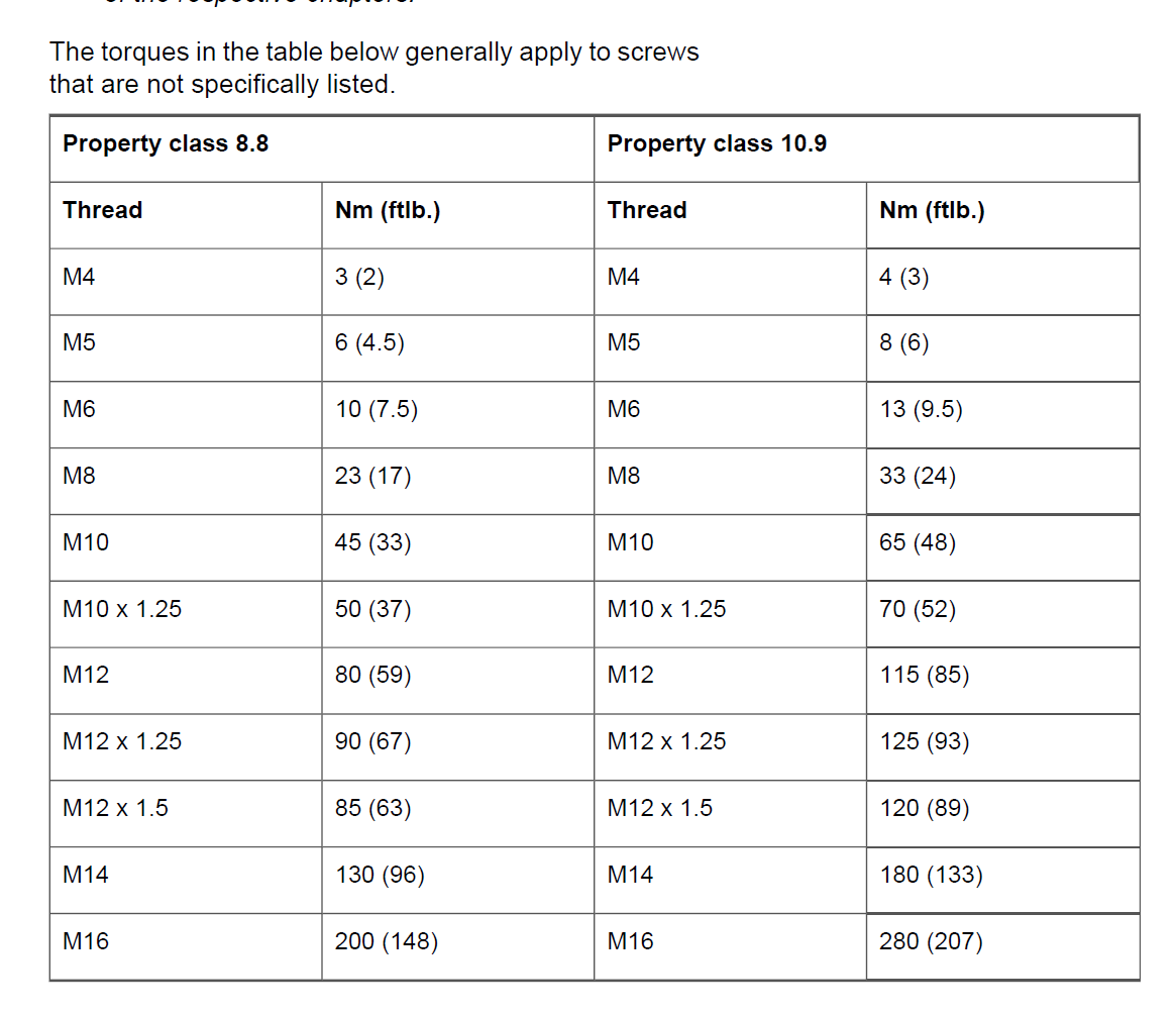

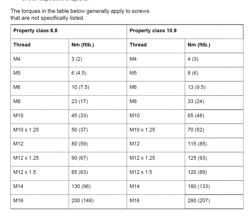

Thanks Doug, but I am talking about the bracket on the engine that connects to the torque arm. It’s attached to the passenger side cylinder head via two upper e12 bolts and two lower e10 bolts. See attached.
anyone have any torque specs for those bolts attaching the bracket?
Thanks everyone for the help. I will eventually be posting pictures of torques specs for the bolts in question. (see above post from me)
