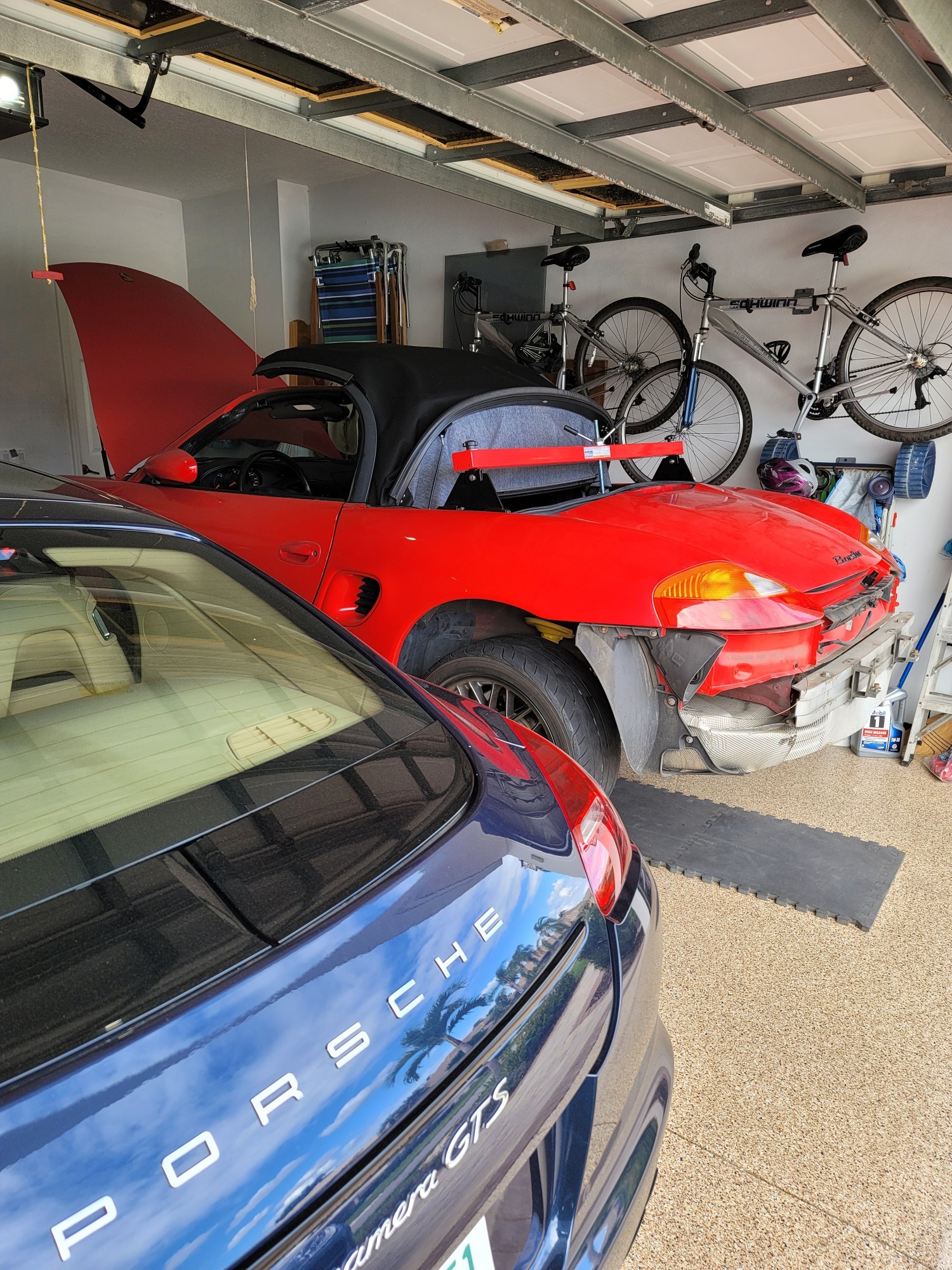

  3. I own one of the first 1997 Boxsters 2.5L sold in America. For sure one of the first sold from Princeton Porsche. I'm the second Owner and I also bought it from Princeton used. I have had the car for 12 years with 90K miles. Its time for the IMS repair and before I spend any money I wanted to give the car a once over. Here are some findings so far- most are the usual suspects Power steering fluid return line leaking at the reservoir. RMS leaking - but no big deal already knew this was to be replaced. Air Oil Separator leaking bad not a big deal. Did a bore-scope and i have oil in the cylinders - looks like valve stem seals, I was having a hard time seeing the cylinder walls with my bore-scope - this is a big deal to drop the engine. Questions - Since this is a super early Boxster and does not have a programmable DME( checked the part number), what engine modifications can I do to increase the HP that can be handled by the current ecu? Performance muffler? Exhaust manifolds( have to replace the current ones)? or should it just remain stock? Have a few other question but I want to see were this goes!

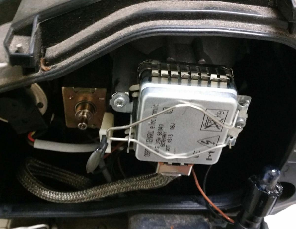

  9. Hello - I would like to ask for help determining what my headlight issues is, please see image headlight4. Just bought a used 2006 Cayenne S and went to replace the bulb in the drivers side which was burned out and broken, but was unable to remove the bulb since it was melted into place. I than pull the passenger side and it too was melted into place(the W5W bulb). Questions 1. What caused this, wrong bulb? 2. what headlights do I have? there are many part numbers and issues 3. Since the bulbs are burned into the socket and the socket is melted can I just get this part? or do I have to buy the whole unit? 4. can I use the valeo bi-xenon units that are for sale on ebay? if so do I have to have a different wire harness and ballast. not looking forward to spending $1300.00 each if i have to replace both Any help would be great , thanks Chris

  13. Why not just go back to the OEM unit; they work pretty well and would address all your issues? It never was an OEM unit, but can I get an OEM unit installed?
