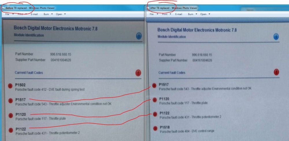

  9. Wizard - I could not find any way on my Durametric to test Fuel delivery/pressure/pump. I hooked up my Durametric last night and got similar errors from before I replaced the TB even though my CEL was not on. (see pic below) I cleared the faults and it ran perfect. Based on this result I will proceed with judgejon's suggestions and try cleaning the MAF and electrical connection tonight. Based on the other posts I read, I also tried the PSM on/off when it was idling real rough but it made no difference. I think to properly assess this idea I will need to clear all fault codes then drive with PSM off for a while. I will try this if the MAF/electrical cleaning does not work.
  10. So I replaced my throttle body on the weekend and did the reset on it, started it up. Ran great for 2 days. Last night on the way home the idle started to drop off then jump up and stabilize, but the car was still responsive. This morning started ok, idled a little rough, then after a few 100 meters the unresponsiveness started up again. Same exact problem I had before. Items replaced to date: ignition switch, cam sensors and throttle body. I would appreciate any input on possible next steps. It must be something electrical/intermittent because it comes and goes? Could it be my MAF sensor? gas pedal? ignition coil? fuel injectors? Is there a way to determine what is happening with my Durametric?

  14. Hi Ahsai. thanks for the feedback. I should have said this in my original post... Yesterday I reset the CEL and did the throttle calibration. Afterwards, I checked the throttle position sensor target vs actual on my Durametric and everything appeared to be in sync ie actual = target. I think this is the test you are referring to. The car ran ok for a 5-10 miles then started acting up again. I will check out the Bosch part. hopefully its not the wiring. thanks for the clarification on the other sensor!
  15. I have a 2003 996 C2 convertible, manual, 124000km I have had several problems over the past few months. My electrical system appeared to be half on, AC fan would not run, no head lights, until I jiggled the ignition switch. I replaced the ignition switch (noticed it was cracked) and resolved that problem. The car would cut out at idle. I had a cam sensor error, so I replaced both. Now the car is intermittently unresponsive/sluggish. Over the past few years the car would become unresponsive or run real rough at start up. I would remove the throttle body, clean it and the car would run great again. I recently had more serious problems where the car was stopping at idle and would not respond at all. Then I got 4 codes when I tried to start it. P1502, P1517, P1120, P1122. Cleared these ran ok, then became unresponsive again, feels like it will die at idle if I don’t give it gas. My gut is telling me I have to replace the throttle body based on the following: Age of the car History of having the same symptoms and cleaning the TB to fix it. TB is clean now but still having problems Questions: Do you think replacing the TB makes sense as a next move? When I look up the TB part online, I see a Throttle Position Switch listed as a related part. Could this be the problem? The part is about 1.5”x1.5”x3/8” with a rotary connection for a spindle. I can’t find it on the engine and can’t see any reason for it as it appears the TB is a completely integrated assembly with the sensor built in. Is this part of the gas pedal? My car is a 2003. Was there an earlier version with a mechanical throttle that this is for? I found this older thread with the same error codes so I posted this here. I would appreciate any help you can offer.
