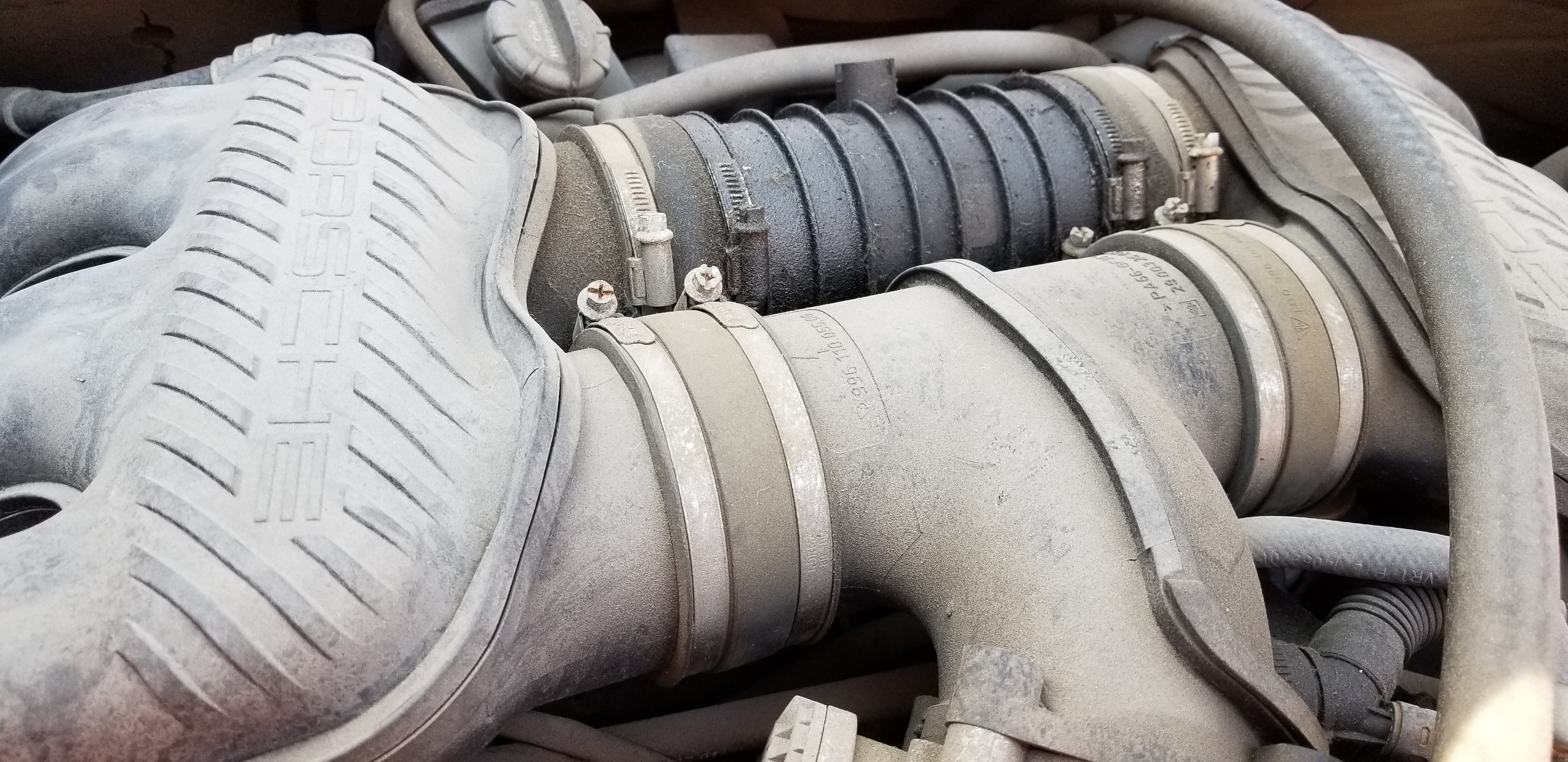

  1. I went into the engine compartment yesterday and saw this oil soaked hose. I am sure a quick diagnosis from all the experts here. I have no idea. Thoughts?

  3. Replaced the oil cap, cleared the codes, and after 60 miles got P1126 and P1133 with pending P1130. I noticed that when the car is cold, the revs fluctuate to the point that if I put it in gear (tiptronic) and hold the break to the point where the car slightly is able to move, the car moves in a non-uniform fashion like is moving forward and stops, moving forward and stops. This happens only when the car is cold. I took some pictures with some visible oil stains...is this normal and what to expect?
  4. Yes you will have to clear the codes, they will not clear automatically. If the codes come back AOS is suspect. When you remove the oil fill cap (warm engine) does the oil fill tube sound like a shop vac? Did the RPMs drop (look a tach)? With engine idle and oil cap on, idle revs from 690 to 730 or so. With oil cap removed while engine idles, revs fluctuate from 640 to 800 or so.
  5. Replaced the oil cap and I got noticeable performance improvement. The faults are still showing up after I scan for errors (P1128, P1130, P1126, P1133), Do I need to clear the codes and let it run and see if they come back? Also, I get some smoke when I start the car when the car is sitting for a couple of days...otherwise, none or very little. Can it still be the AOS? T
  6. AOS is suspect... What happens when you remove the oil fill cap while the motor is running (warmed-up at idle)? Removed the oil cap at idle and running temperature. Some rough idle but not to the point where the car would stall.
  7. Thank you both.....will venture in over the weekend and let you know....Jager, what should I be looking for with the oil cap removed at idle? kbrandsma, not original owner...car has 60,000 miles....engine bay dirty but I do not believe oily.....will take again a look now that I know what I am looking for. T
  8. Thank you K....I have done 1 and 2. I do have a yellow oil cap so I will go ahead and replace. Today, in addition to P1130 and P1128 I get two "pending faults" P1126 and P133. Does this point to a more particular issue? T
