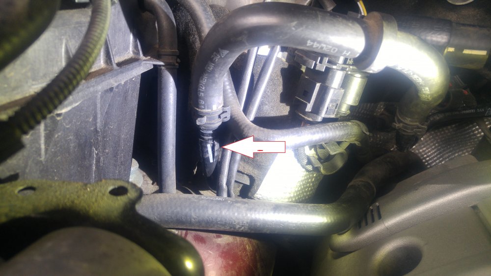

  11. I just found a cracked hose - cannot identify it (attached pic). Looks like it is going through the firewall
