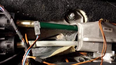

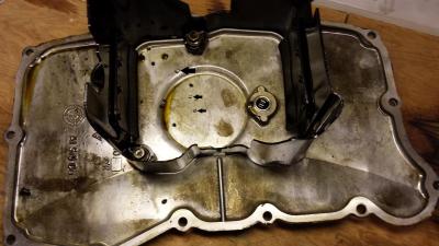

  1. Just installed the IMS Guardian Jr in my 99 911 C2 coupe 6-speed (138kkm) and found some loose bits in the oil sump pan. They are not metallic, ie. not bearing bits, so I was wondering if anybody knows what they are? It is the first time I remove the oil sump. I also found one piece in the oil filter. This is the first time I find a piece in the filter and I check the filter every time I change it every 3k to 5kkm. I am thinking that the black bits that are also in the pan are probably from gasket sealant as they are soft. I am worried about the square white bits (about 2mm in size) though. I'm thinking the water pump is overdue to be changed. When the engine is hot in the summer the temperature gauge needle sits just right of top center. It has had the IMS upgraded and the RMS seal replaced at 110k along with a new clutch and flywheel at that time. P.S.: The IMS Guardian Jr went in pretty easily as the instructions were good. I would just add that the spot I found to run the cable from inside to outside the cabin is between the shift cables under the center console. Every model year is different so no instructions are given to do this part. Thanks, Carl.

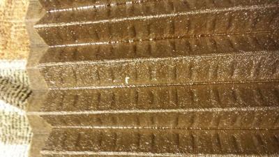

  12. Hi, The work on my is progressing. Although slower than I would like. But the dealership is in the mist of expanding so I am being patient. He has done about half the work. He has spent about 20 hours so far. So I expect another 20 or so to finish the job. I was there for an update and took a picture of one side of the block after it was de-coked.
  13. I would echo that. They are a first class organization. Have you talked to Jason at AutoImport here in Ottawa? They might be able to do it as well. I saw the chains at the bottom of the case. They had a white paint mark on them. I asked him about it and he said it was to mark the position. I'm guessing he must of slipped the cam shafts off .
