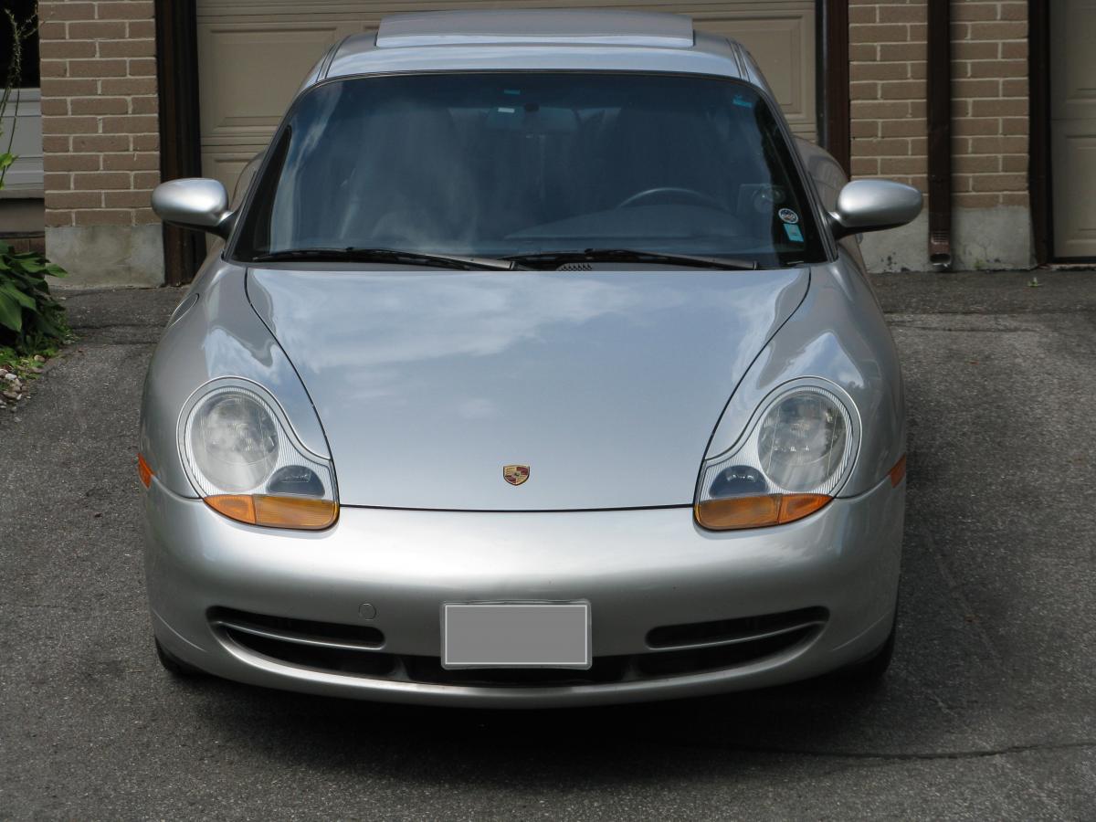

  9. The driver side headlamp (the part inside the assembly) has a small yellow spot just in front of the bulb. The bulb still works. It just looks unsightly. I would like to clean off the spot if only for aesthetic purposes. How do I dismantle the assembly? I took the headlight assembly off the car. Now, I need to separate the black casing from the clear plastic cover to get inside the headlight. There two screws on one side of the casing and three plastic snaps on the other side but they only keep the rubber seal in place. But I can't see how else the assembly is kept in together. Help!

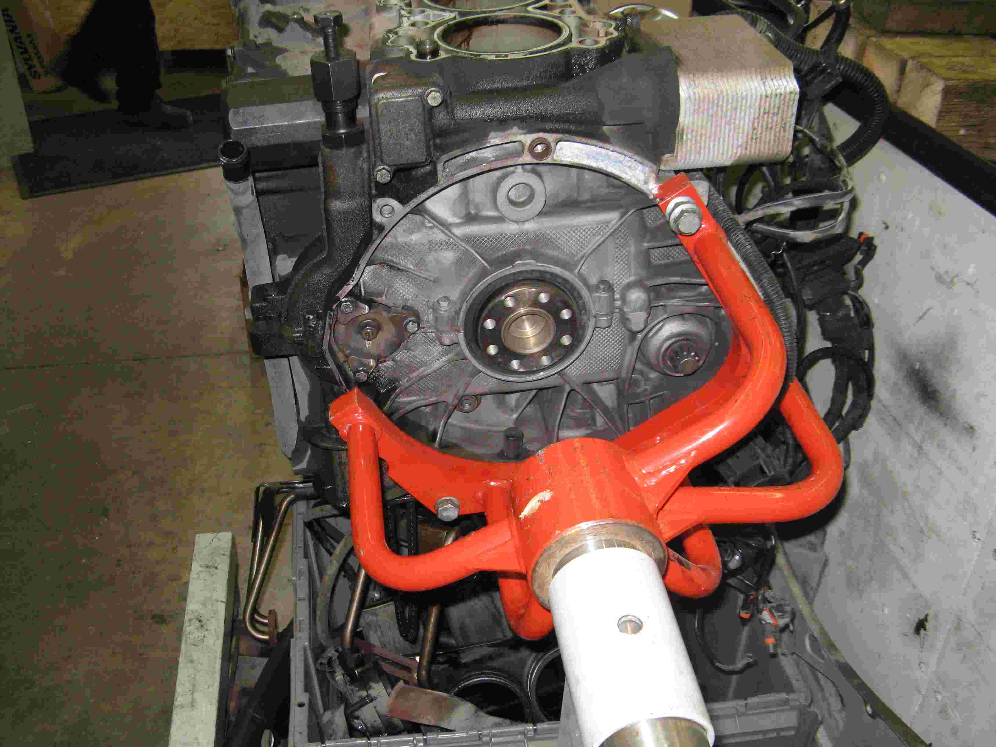

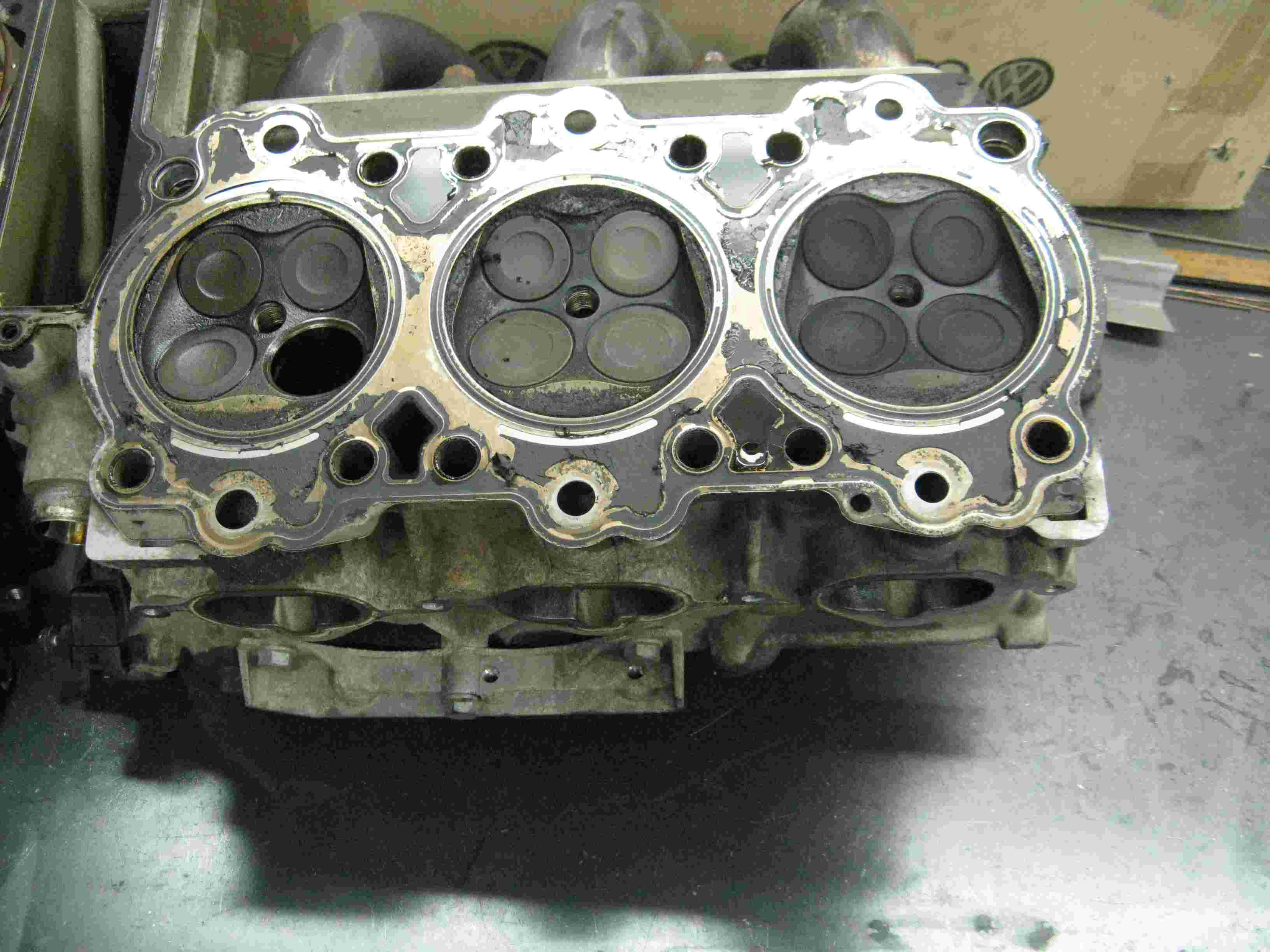

  12. Hi, The work on my is progressing. Although slower than I would like. But the dealership is in the mist of expanding so I am being patient. He has done about half the work. He has spent about 20 hours so far. So I expect another 20 or so to finish the job. I was there for an update and took a picture of one side of the block after it was de-coked.
  13. I would echo that. They are a first class organization. Have you talked to Jason at AutoImport here in Ottawa? They might be able to do it as well. I saw the chains at the bottom of the case. They had a white paint mark on them. I asked him about it and he said it was to mark the position. I'm guessing he must of slipped the cam shafts off .
  14. Thanks for all the replies. Thanks for warnings and the references. It's good to know there are some good Porsche mechanics not too far away. I have full confidence in Mark Motors and Terri the senior mechanic. Terri has been around almost as long as the dealership. He has ordered about $4,000 in parts, including the flywheel and clutch ($1,500 and $900 respectively). He did mention, as an aside, that all the springs could be replaced. He knows I'm on a budget. I decided not to do that as I think that it was an isolated incident. The chain guides are grooved and will be replaced. Yes, the cam chains have been removed and are not in the pic. I suspect it will take about 50 to 70 hours do the work. I will post tha actual time when I get the car back.
