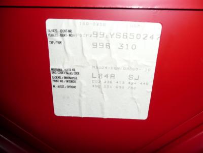

  4. Unwrapped and checked both harnesses, no black with blue. Any other ideas? Is model year something other than it being a 2000? Is that what the M96.04 means?

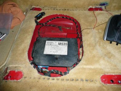

  6. Please help, I've looked and looked but can't find this elusive Reverse Wire under the seat or anywhere else near. I have a 2000 996 cab, no Bose, no memory seats. I just can't see why it would even be coming to the alarm unit. Thanks!
