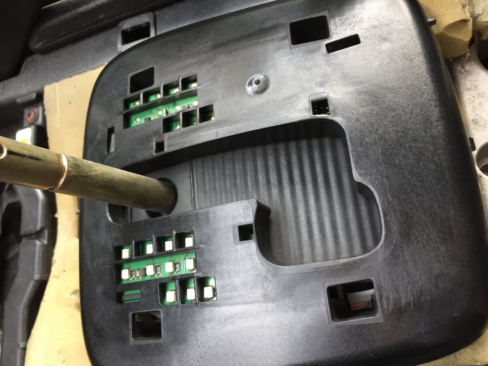

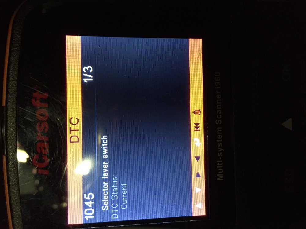

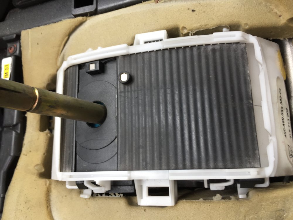

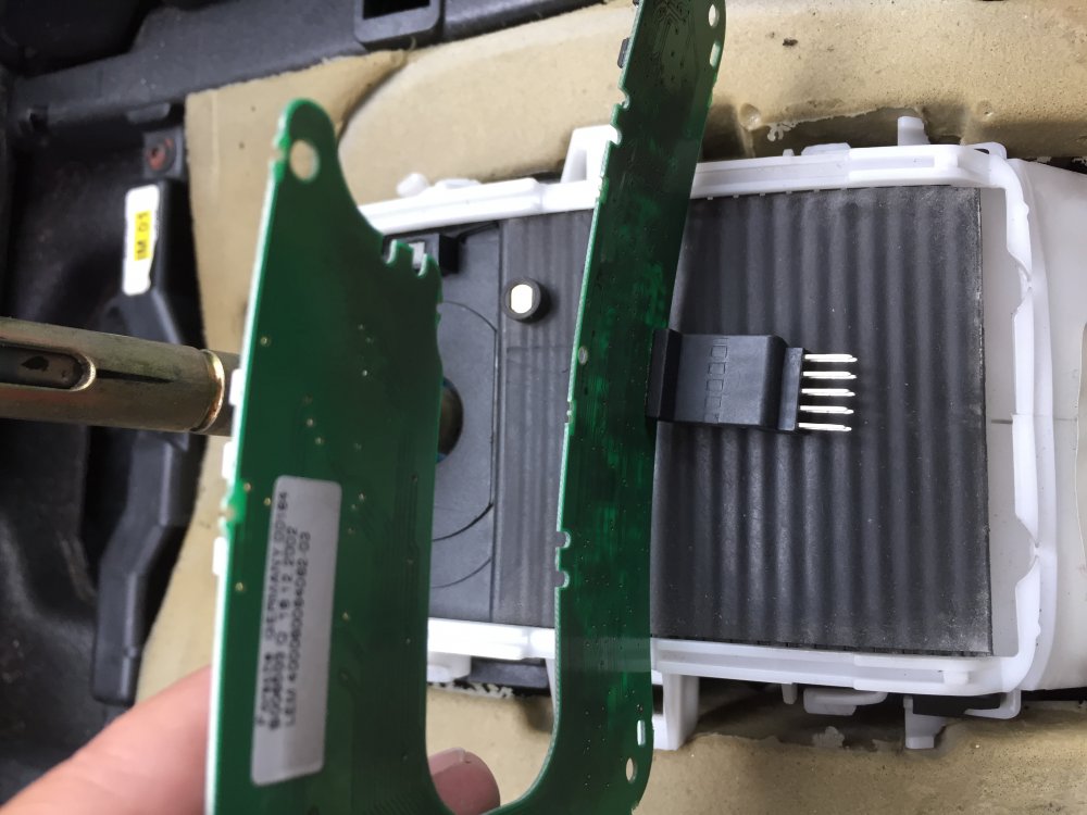

  6. Would like to refresh this thread. i have a first genaration Cayenne S which stay for almost 2 years now without driving. I try to reactivate the car now. New battery and the car started. Some codes came up which i could clear. The problem i still have is the gear selector. When the position is P the display still is showing "put selector to park position" the key doesnt come out easy . I have to wiggle a bit. i disconnected the gear selector to check what is going on there. I couldnt find any broken parts. Magnets are still in place. so what it can be? what is found out, when i am taking away the circuit board and putting the selector in P it works. Dont show message on the display any the key is coming out with a click how it must be. what could be the problem?
