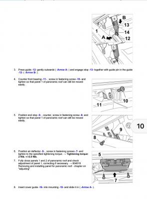

  4. Here is the pic. Part no. 5 on the picture down
  5. I have one which is making me trouble sometimes. The panels get stuck here and there and when driving with open roof a little bit faster i didnt work at all after. I needed to close manual with emergency tool. I need to check the wind deflector now. Its not open proper on my old Turbo. I found a helpful document. I made a screen shot and would like to ask what and where is this part no. 5 on the last picture down. Thank you in advance

  11. Found answer. O ring must be. Thank you
