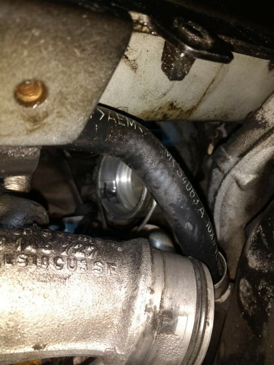

  10. Changed the pressure hose to the wastegate. New blue silicon line. Changed the tube which is going away from the turbo housing in direction to the belt. No. 15 on the diagram there was already a damage and previous owner fixed it in a very special way

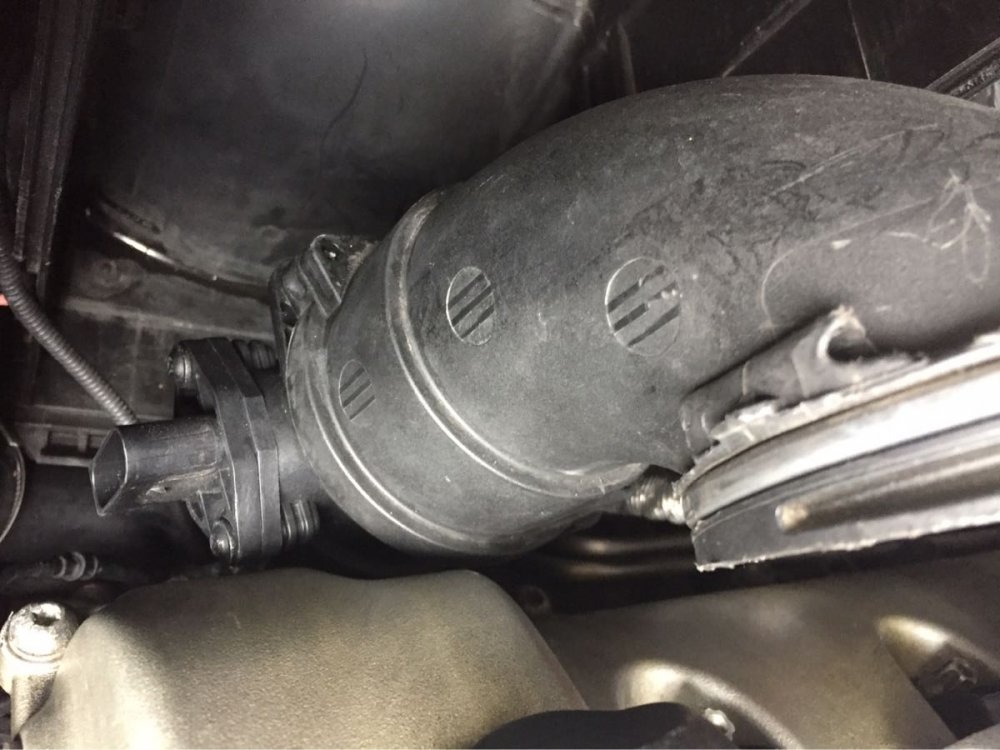

  11. Major work on the drivers side Turbo. I can see that there was already some "specialist" working here. Take away air filter housing to get access. Take away tube with the MAF. Changed the o ring between the metal hose and the charger

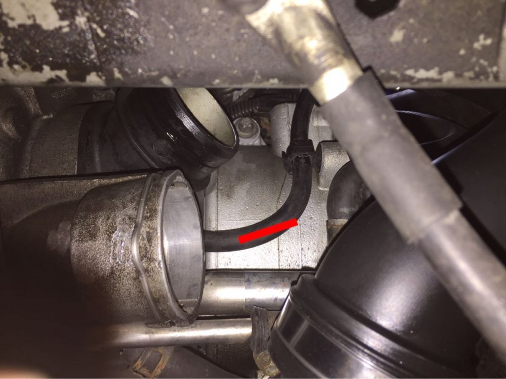

  14. To get access to the small pressure tube i disconnected all this stuff around. Airbox. Tube with the MAF. Tubes which are going to turbo charger cold side outlet. But, this small tube is hidden and i can hardly get my hands to the end where its connected to the Charger housing. No way to change this. Try from up and down and from wheel well. Nothing.

  16. Very good picture. Thank you. I see you take away the connection piece - part no. 3 - which has a gasket. I don't have this gasket and can't get it until tomorrow. I will see if I can manage to change the pipe without removing the plastic part no. 3
