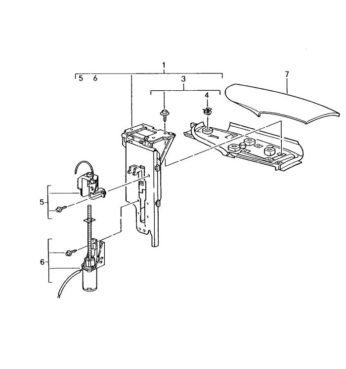

  1. On mine the piece that you have circled and mechanism below it was broken. The motor was good condition but the unit functions much the same as a window regulator and some small plastic piece had broken off. You will want to verify the unit is getting electricity or physically see that the unit is broken before getting a replacement. If you look in the manual or search online for the procedure for emergency top operation it tells you how to lower the side flap manually (don't go through the whole procedure). Once the side flap has been lowered you can likely raise your roof electronically to give you access (if needed, don't remember) to remove the flap mechanism. I replaced my unit with a used one off of Ebay. The cloth covering can be swapped out with the one from the old unit so you do not need to get one of a matching color.

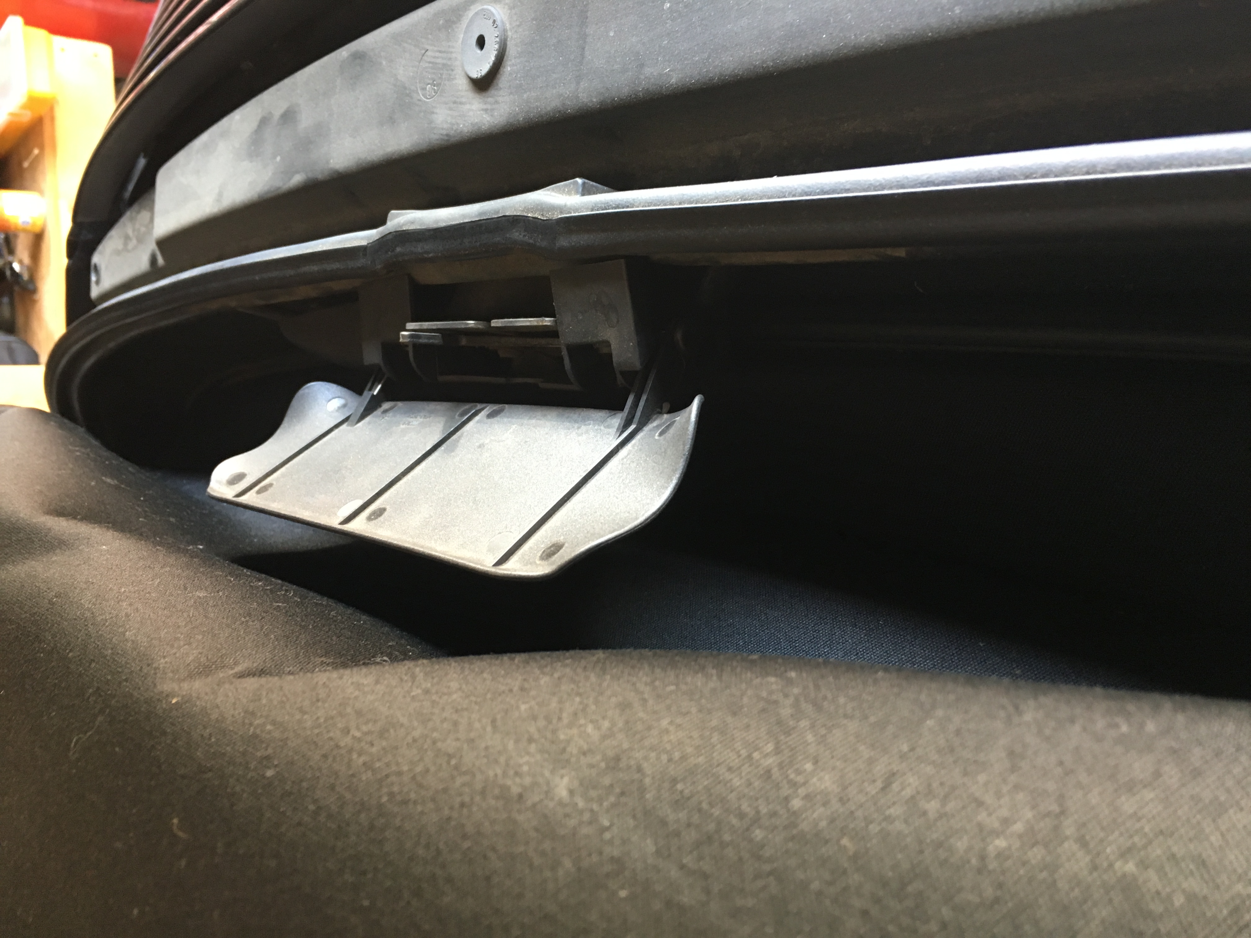

  2. Make sure the cloth from the roof is folding nicely. I had this problem and it turned out to be a plastic roof stop at the rear of the roof compartment that was not being raised when the roof was lowered. The stop prevents the fabric from overrunning the back end of the roof compartment. As a result the roof material sat on top of the stop instead of being stopped by it. This caused the bunched fabric to fully cover the rear catch or sit too tall and prevent the clamshell from closing far enough for the final engagement hooks to reach. In my case it turned out to just be a couple of broken plastic clips holding the stop mechanisim in place. Hope yours turns out as simple

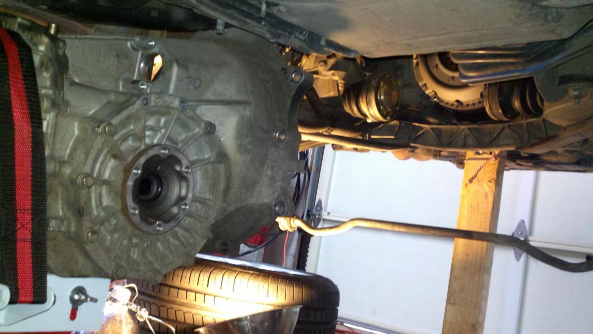

  9. I replaced my clutch/IMS/AOS two years ago at 100K miles. '00 996 C2 original clutch (I believe). 1) My slave cylinder showed no signs of leaking at this mileage. After verifying that the fluid you are seeing is not coming from another source I would replace the slave cylinder. 2) I didn't replace my flywheel and now I'm sorry. My flywheel is now likely to be the next point of failure and will likely to take the clutch disk with it as it goes. If you are going through the trouble of dropping the transmission it's nice to have the piece of mind to know that you wont be doing the job again for a while. Then again if you are only going to keep the car another year or two you might get away with it.

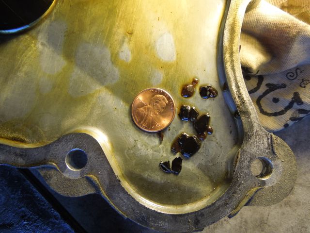

  24. Congratulations on your C4 cab. There is a lot to learn. The few things I've picked up so far are: 1. If you start looking at all the things that could go wrong you will drive yourself crazy. 2. There should be many fluid changes in your future. I dropped the transmission and replaced the IMS s well as the AOS. The bearing was in perfect shape but now I have piece of mind. I do have a slight start up rattle so I am replacing the chain tensioners this week. I am now relatively sure that the plastic I saw was from my chain guides. They will have to hold on a bit longer until I can scrape together the money or gain enough experience to replace them. I now have three new style chain tensioners sitting in front of me 188-01, 186-01, and 180-56 but I have to do some more research before I know if I should install all, some, or none of them with my old style roller link chains.
  25. Not unless he also has water in his oil. The oil system and coolant system should be separate unless something else is wrong. Thankfully there is no detectible intermix. The few small brown bits I see I tend to believe are from the chain guides. These are so few I would tend to take a monitoring approach. Some of back plastic bits are almost the size of a pencil eraser and as thick as a dime and there are many more of these. If these are from the chain guides it scares the heck out of me. I am hoping that I can track the source down to a perished AOS, oil filler tube or some such thing. Other than plastic bits in the oil are there any other signs of chain guides going bad short of catastrophic engine failure? I know splitting the engine to replace the guides can't be cheap. I paid cash for the car and am already in another 3K so I'm tapped out for a bit. I'd really like to be able to drive the car but I'd also would really like to be able to continue to drive it. Any thoughts or opinions?
