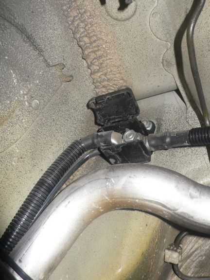

  6. Hi8... It would be easier if you had the part description included, if item 18 is the single post terminal, then that would be the battery + lead to the terminal post included on the attached pix, then from the terminal to the starter, I think???? Anyway that terminal post housing on my 2003 C4S is on the right side frame at about the firewall. It's hiding high on the frame...

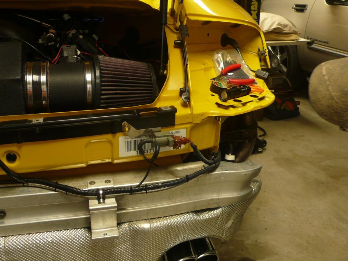

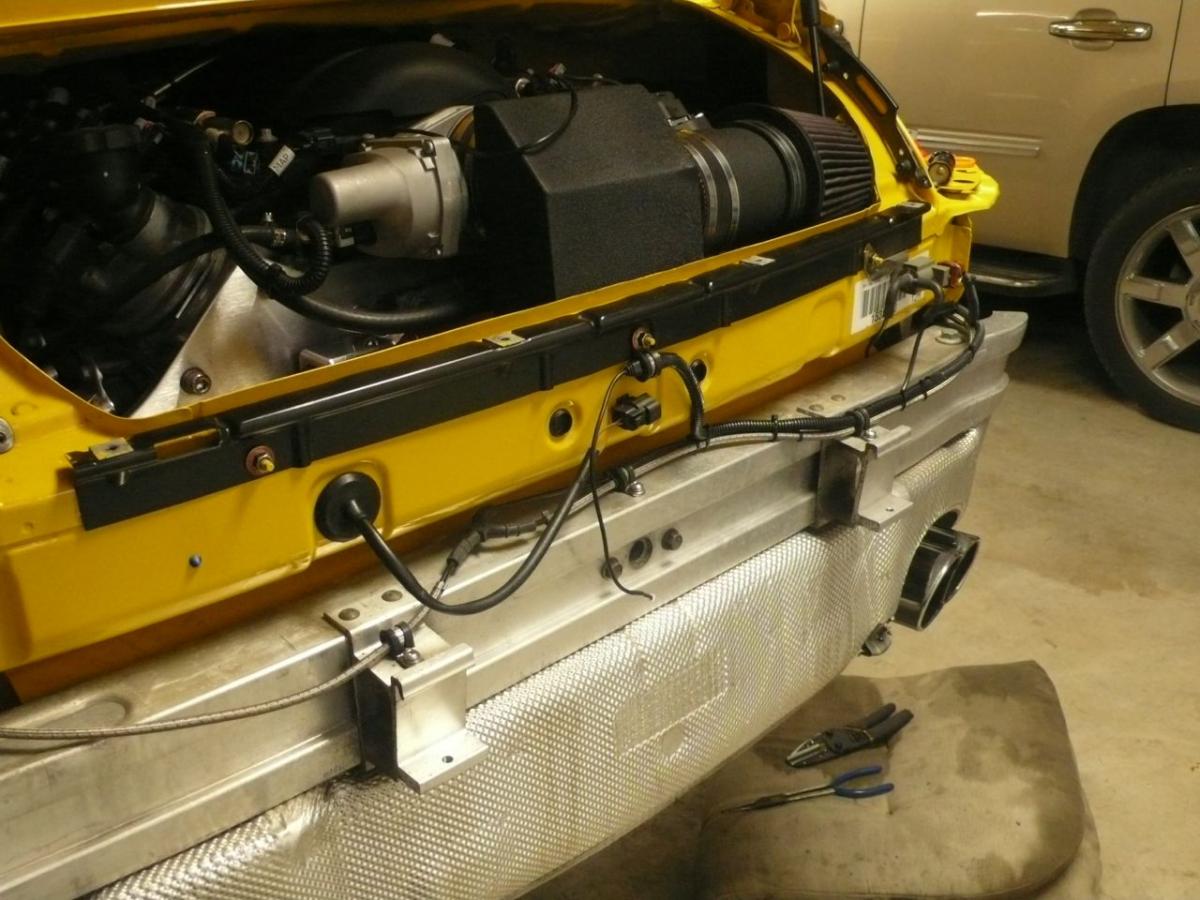

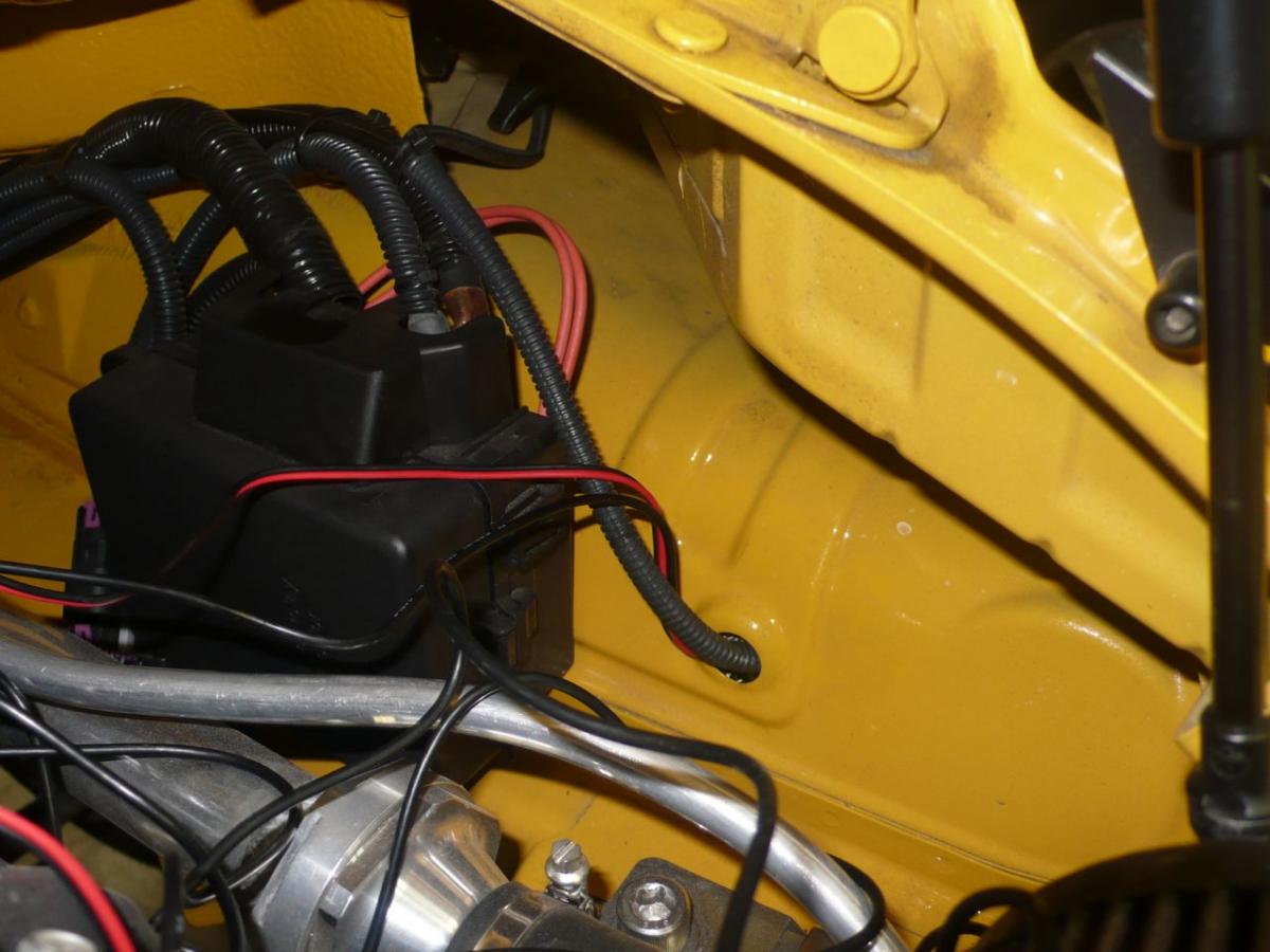

  7. Here's the way I ran my backup camera wiring. However the one problem area that I alluded to early is that you need to wrap the wiring that runs behind the aluminum heat shield where the muffler is mounted. I used some exhaust pipe wrap as an added shield. Here are some pixs...
  8. Hi8, I've got the rear valance down and tomorrow evening I'll run the cables. One way I was thinking about running the cable is through the fender well where my PSE vacuum line goes through a rubber grommet. However the muffler is right there and the only protection from heat is the foil insulation. Once into the engine room I'm going to look at going through the big grommet that houses the 2 engine harnesses. They are located high on the right fender well. This will allow me to get into the rear seat area...
  9. Hi8, I never intended to connected the GPS power wire to the backup lights, however I had a friend that just installed a backup camera in his truck and he thought there was a backup camera wire out of the back of the monitor that switched the screen to the backup view. Once I have the new Nav I'm sure I'll come up with the correct wiring. I'm off to the garage to put the car on the lift, then I'll remove the rear bumper/valance to install the backup camera and run the wires into the engine room. From there I can run wire forward and into the right side tail light housing. Thanks for the reply...

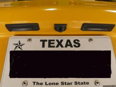

  11. We've run a lot of new wiring up the left side threshold area during my engine swap, that gave us good proximity to the fuse panel. However having had most of the interior out of the car at one point or another I have yet to never figured out how to run wires forward through the center console under the rear seat pan. I bought this backup camera from Crutchfield, very small, 165 degree view, it reverses the rear view. It comes with a 6' pig tail and 22' of cabling with connectors. I had the local avionics guy cut down the 6' pigtail to 1' so I didn't have a bunch of extra wiring behind the bumper. The wires are small gauge so I didn't want to muck up the wiring with my solder job. Nice unit, a tad pricey... http://www.crutchfield.com/p_074RVC115T/Accele-RVC1150T.html Thanks for the replies...
