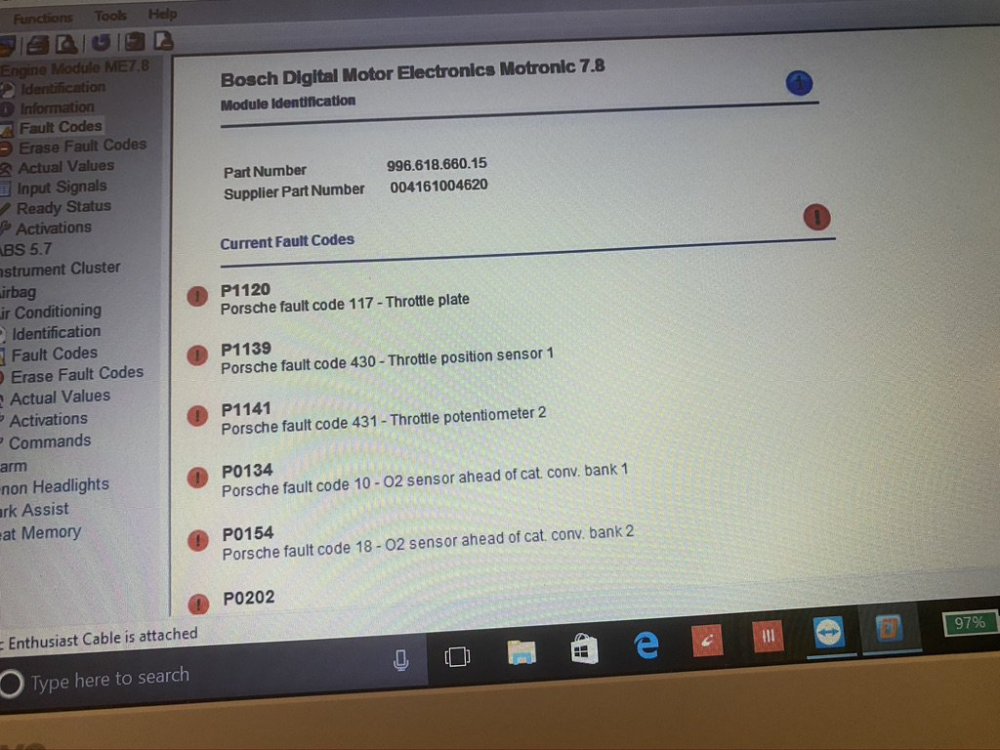

No, I believe both ECU's have their own job... The Conversion utilized the GM gas pedal, so like you I was surprised when the Porsche OBD port cancelled the check light. It has been years since I hooked up the Durametric program, but I did today with these results... I just thought I need to see if I can date when these codes were thrown... At the top of the attachment it says, "Current /Fault Codes. I want to get to the bottom of this pretty quick, I've never have been flat bedded home so far. I did get stuck in Winslow, AZ for one night with the original engine. The idler pulley bolt backed out, a local towing service came out with his flatbed, took me to the Chrysler dealer, charged me $85.. They had the Porsche dealer in a neighboring town overnight the parts. I was on the road again by 10:00 the next morning... All in all it was a memorable experience and meant some nice people. \ -
Coming home in the middle of the day, probably high 90's, good oil temp and water temp was good when all of a sudden my gas pedal went away and the LS3 V8 cough and quit. I tried to restart without success, Finally it started and got me home without further incident. I plugged y OBD II reader in to the GM port and it wouldn't clear, then plugged it into the Porsche port and it cleared. I have 90,000 miles on the 2003 C4S model and 25,000 on the LS3 motor. NMy question is this a routine mileage event or something else? Certainly it was more of a "have your car service" event since the gas pedal went away and the engine stopped. I was surprised that I cancel/erase it on the Porsche OBD port. I was hoping for some rare insight which has its complications, but still puts a smile on my face... Thanks, Mitch
