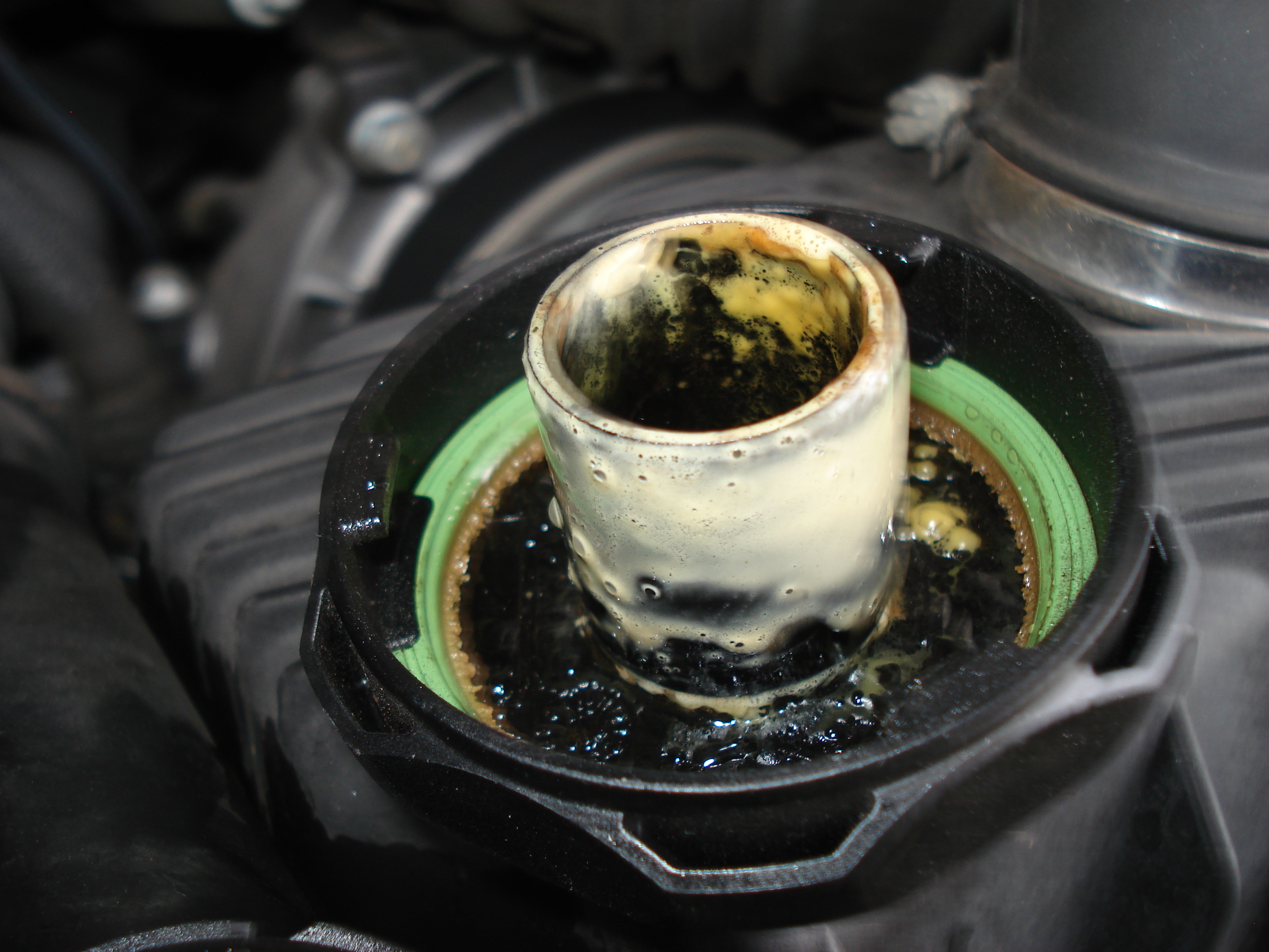

  1. I replaced my oil filler tube a few years back when the car was about 10 years old.

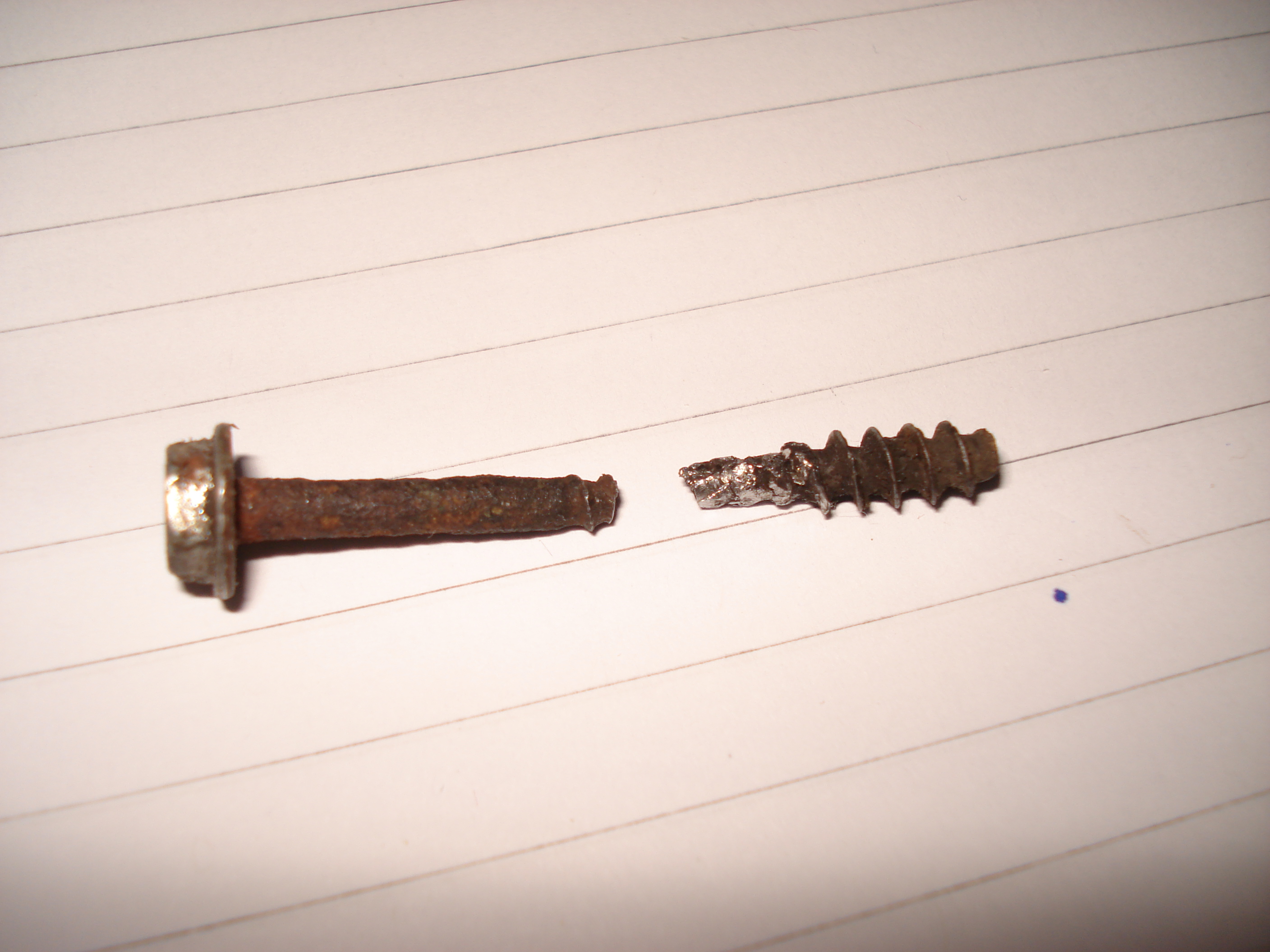

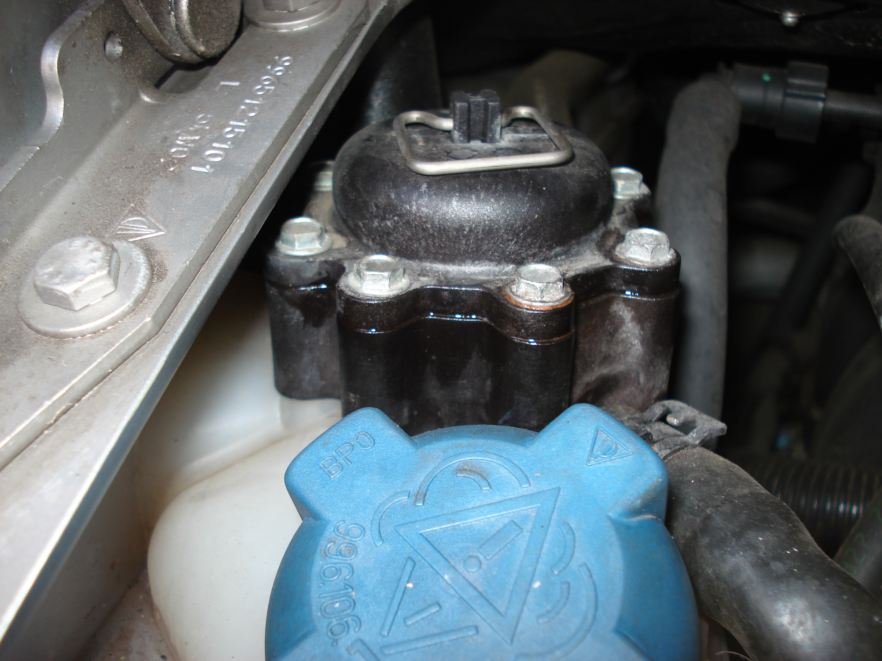

  4. Mine's a 996 3.6L from 2003. If it's any consolation to you, soon after buying mine in 2012 with a mileage of just 40K within a few weeks I had coolant coming out in the same area. It was caused by a fractured alloy return pipe. There was also coolant at the top of the reservoir, in the well, just like yours as one of the screws holding the release valve had corroded. I replaced the coolant reservoir and at the same time the air oil separator and the oil filler tube. Also the small bore alloy return tube which I sleeved in plastic pipe to avoid the problem re-occurring. Before you start pulling the thing apart you need to find the source of the leak. When it's cooled down top up the coolant. Get the back up on blocks and see if you have a leak and find it's source. It would help to pressurise the cooling system slightly, but don't overdo it. Are you sure that the oil in the reservoir well is from coolant? It's not just oil that has been spilled here and mixed with overflowing coolant? Is there water in the sump? Could the oil in the spillage have come from coolant washing oil off the outside of the engine on its way down? I attach some pics of the fractured coolant pipe, examples of moisture in the filler cap after short winter journeys, and coolant leaking from the coolant valve cap.
