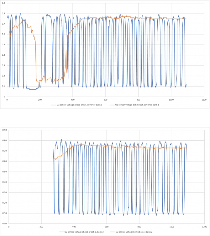

  2. Installed Carnewal 200 cell cats today and here are the O2 sensor voltages. CEL still on but things sure look better on both sides, and the exhaust rattling is gone. Bank 1 cat had lots of loose stuff inside it.
  3. 2002 C2, 95k miles, original exhaust and O2 sensors. A few months back the CEL went on, Durametric says P0420: Porsche fault code 40 - Cat. conv. efficiency bank 1. CEL has stayed on so I investigated further. Pre- and post-cat O2 sensor voltages shown in attached charts, upper chart for Bank 1 and the lower for Bank 2. Warmed up the system at idle, then throttled up to 2.5 - 3k three times, two short, one long, during which time all sensors went near zero. It looks like Bank 1 (upper chart) post-cat sensor is showing a problem while Bank 2 (lower) looks fine. (I started capturing Bank 2 after Bank 1) Also for a few years there has been a little rattling on the driver's side exhaust which I've suspected is a failing cat, but the exhaust system has not been recording any faults until now. After having read a few related threads, it seems fairly certain that the Bank 1 cat is failing, perhaps with a loose element that reduced cat performance after the third throttle bump in the charts below. I'm leaning that way because it appears the sensors are all reporting data at about the same rate, oscillating when expected, except for post-cat Bank 1's sensor which begins the capture looking like it is largely reporting correctly but ends with oscillations that shouldn't be there. There has been no perceptible change in performance, and I have over a year until the next smog inspection, so there's time. Does this information indicate a pretty strong likelihood of a failing Bank 1 cat? Or are there additional diagnostic steps I should take to eliminate other causes?

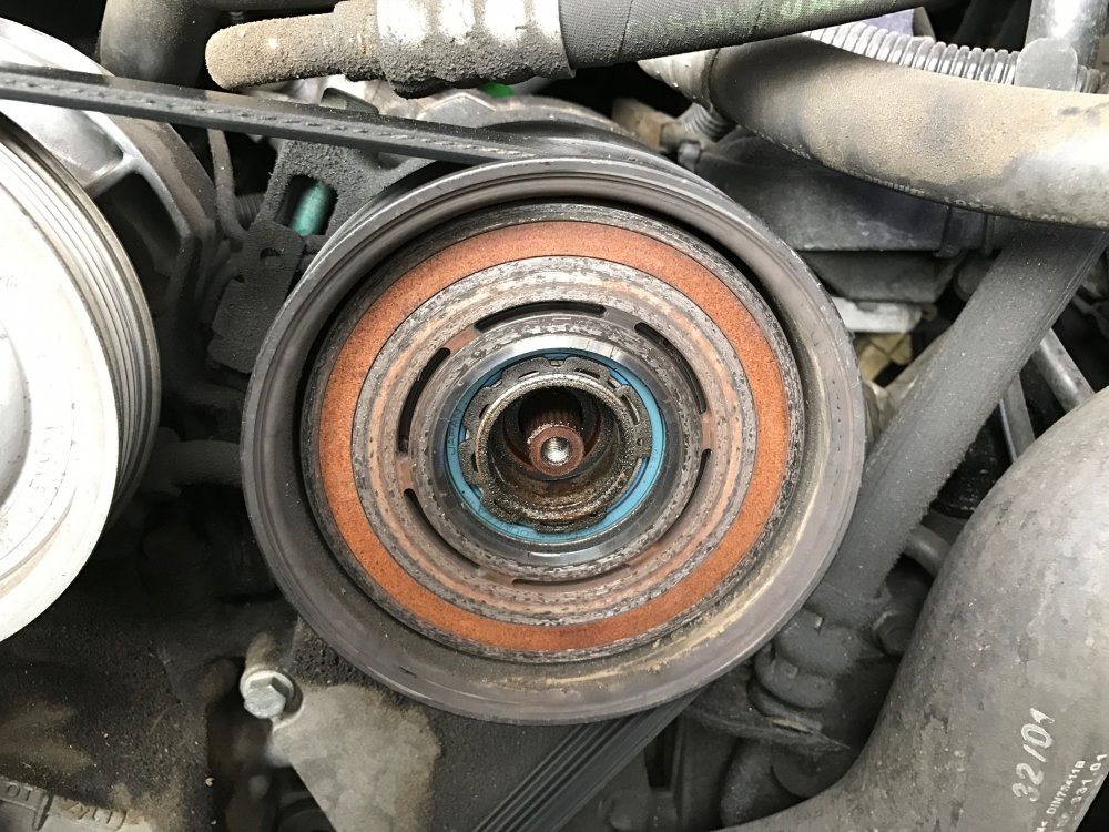

  10. I bought a used clutch from local PartsHeaven (delivered the next day), $150 plus tax and shipping. They decided it was easier to just send me a whole compressor instead of pulling the clutch off. It took 30 seconds to remove the clutch pressure plate from the "new" compressor and 20 minutes to install it on my compressor, most of the time being to R&R the air filter housing. That is the quickest saving of $1000+ ever. Seems to work fine, at least it spins when the A/C control is turned on and doesn't when it's not. So if anyone needs a used Denso compressor without the outer clutch pressure plate, I've got an extra :-).
  11. @Judibake, this is great info. I was not even aware of DCauto.com and yes, they have a used clutch for $100. In my case, it looks like the outer pressure plate unscrewed itself and simply fell off. I looked all around the engine compartment and there's no sign of it.
  12. Super old thread but same question. My compressor's clutch simply *disappeared* last week. Mechanic looked through the engine compartment on a quick inspection and could not find it. The compressor looks OK but the electromagnetic clutch plate at the front of the assembly is simply missing and the clutch does not engage. Sunset Porsche now has a full parts catalog online. Clutch by itself is $642; full compressor assembly is $1258 (new, I suppose, 996-126-011-52). Pelican has the full compressor assembly from Denso for $499 (new, 996-126-011-BX-M11), and Porsche compressor assembly with clutch, also new, for $661 (996-126-011-BX-OEM).
