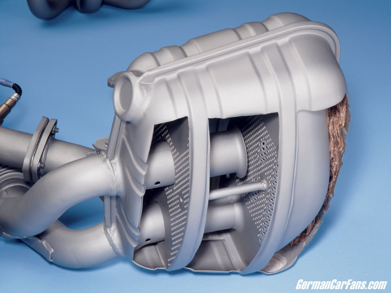

Outside the subject , does anybody have the detailed picture of the inside of PSE mufflers or a pic of a gutted one. I want to get my stock muffler hacked just like the PSE one with custom made tips that are not fake. ( I am after single tip look). The reason I will not purchase PSE is, there are no weight savings or power gains plus I would hack it to be loud all the time so no valve needed.
Here is a cutaway view of the muffler.
The bottom is the inlet, the middle is the outlet.
If you connect a pipe from the top (capped) outlet and connect it to the middle pipe, you have in effect
created a PSE muffler ( it bypasses the middle chamber , that's why it is louder )
Also, since the exhaust only goes thru ~1/2 of the muffler , there should be less resistance, therefore a few HP gained , although Porsche does not claim any.
Good luck .

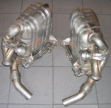

Here is a picture showing the PSE mufflers.
Note the bypass pipe with the shut off valve in it .
That cutaway pic is great. It will be helpful for my guy to understand the work that should be done.
