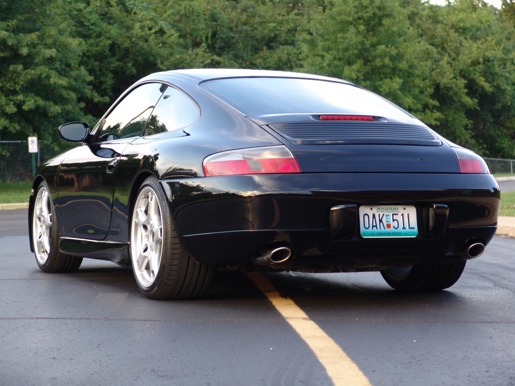

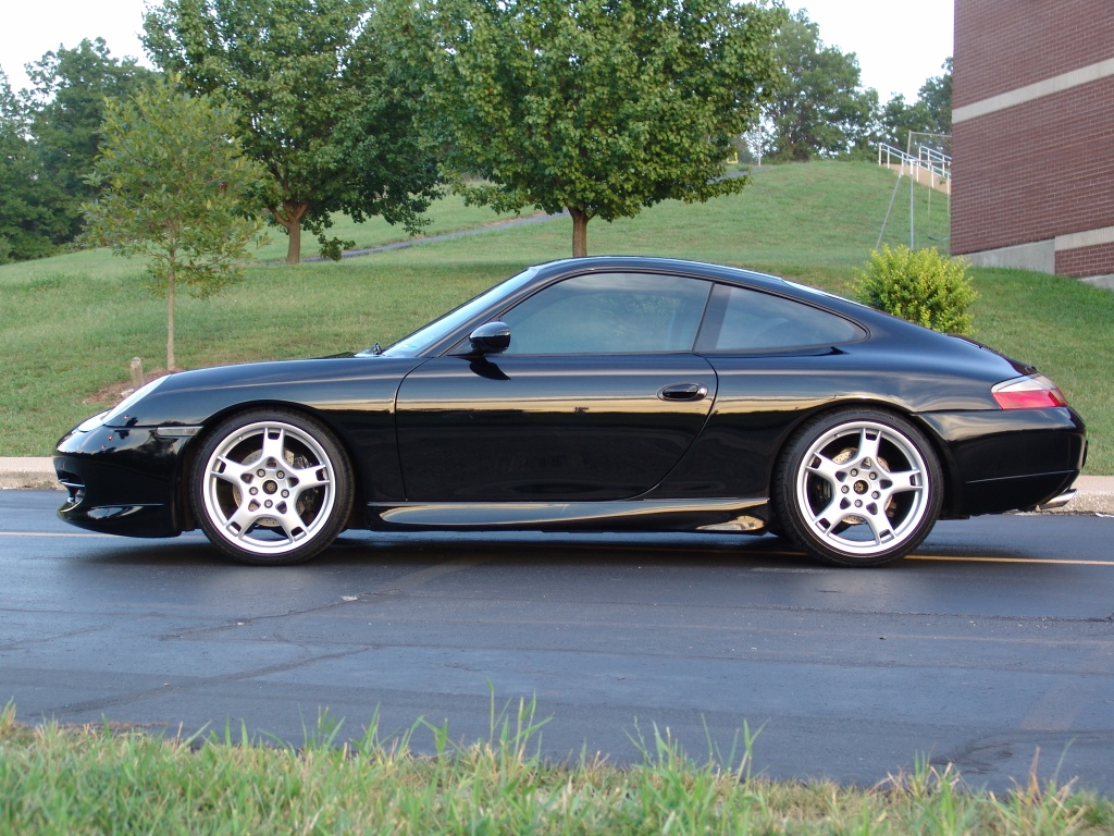

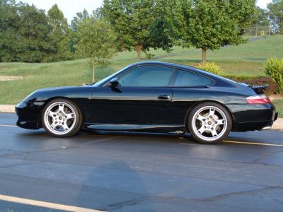

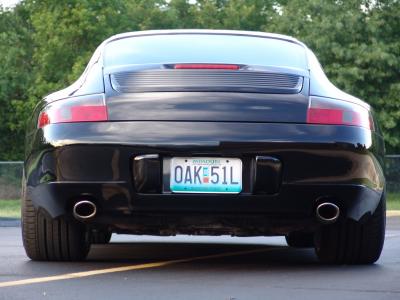

After doing my install, I took the car to the dealer and got an alignment done and they set me up with about 1 1/2 degree of negative camber at all four corners. The car was fantastic on the track. Much better than I expected it to be. I guess I was expecting the infamous 911 heavy *** end to bite me but the car was pretty neutral. It still seems a bit on the understeer side. I think I can eliminate this and get it even more neutral with a nice fat adjustable sway bar in the rear from H&R. Here are some pics of the car. I didn't have my center caps on yet but you can see the car with the 19" 997 wheels.
I did go with Continental Sport Contact 2's in 235/35 and 295/30 instead of the Bridgestones. The Bridgestones are not recommended on 11" wheels. The Continentals are Porsche OE N0 or ribbed. After looking back at the tire and wheel setup. I would go with a 315/25 in the rear to keep the overall diameter closer to stock with 18" wheels and 285/30's.
