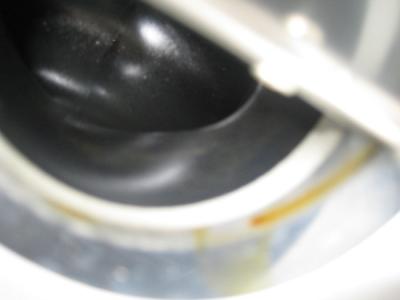

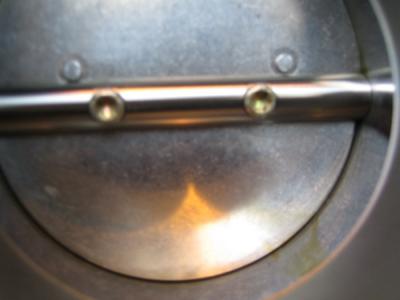

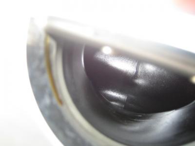

As some of you may know, I started the same forum topic about the K&N aircharger. I have experienced continuous CELs due to MAF reading errors since install (never had any errors or CELs prior to install). Since installation of the K&N aircharger, my 996 also stalls frequently on the freeway or while in the upper gears when I suddenly back off the throttle and coast. Today, the car died with a strange clattering noise.
There has been much speculation about oil from the K&N contaminating the MAF and accumulating in the throttle body. I completely disassembled mine today and found NO EVIDENCE OF OIL ACCUMULATION. None in the throttle body (bone dry) and none in the air intake tube from the filter. Just to be sure, I used K&N filter cleaner to wash the majority of the oil out of the filter, let it dry and reinstalled it. After about 10 miles, I came up with the same CEL and stalling on coasting after deceleration.
I also very thoroughly checked all connections and seals, and cleaned my MAF with electrical cleaner (it already looked spotless) prior to reinstallation and testing. I'm quite confident that my installation is about as optimal as it can be as I am a professional auto restorer and have performed mechanical work for over 20 years. So any type of install error is highly unlikely.
