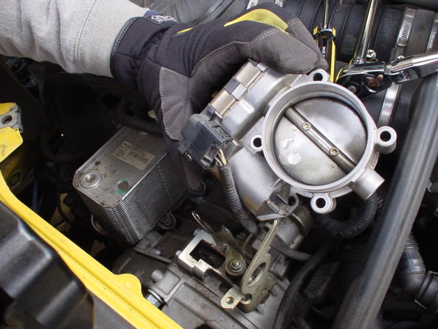

any pic for throttle butterfly?
and how to clean it?
Just take the air cleaner and intake tube off the throttle body - then using a spray carburetor or fuel injector cleaner spray the butterfly on both sides until it is clean (no black carbon). Don't get the spray on your paint as it will damage it. You can use your finger to hold it open or you can take the throttle body off the car like I did on this (egas) Boxster.
