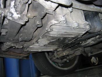

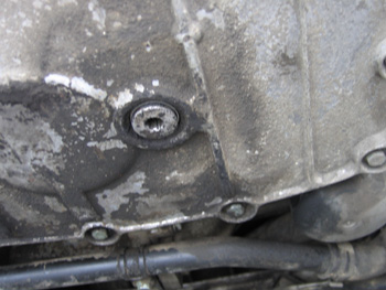

Now for the brown cosmoline; where should I look for it?
I looked under the car and all I see is black road grime. On the top of the engine it is Black and shiny and I can see the word porsche on it
Edited by evansaero
My cosmoline covered engine pan (original engine).
Orient Express's second engine replacement (clean and shiny).
It is the original engine. I guess the only thing left is the DME

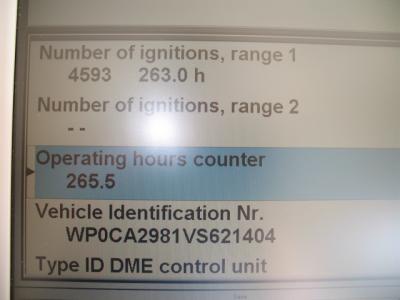

But, just for grins, and all you folks....
1997 Boxster with 61,041 miles on the original engine.
265 engine operating hours per the DME that was replaced last year.
2,109 air bag hours on the original control unit.
You should not mix operating hours with mileage or an engine replacement, or it will make you sick.

With the car you give an example with the the air bag miles per hour are almost dead on with my cars engine miles per hour, but the air bag is way off and I mean way off.
61041/2109=28.9 (Your car example) air bag *Close match
50025/5473=9.14 (My car) air bag Does not make since (It's all in my head) Dam't I can't get it out of there :wacko:
50025/1575=31.7 (My car) engine *Close match
So yes the engine and DME do not look like they have been changed, and yes you had the answers right on rennlist. Thank you :cheers:
