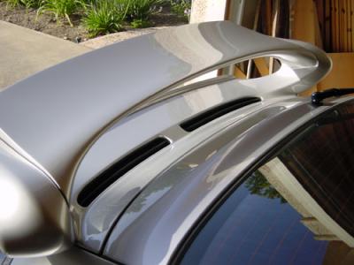

Here is my Aerokit Cup wing in the middle position (not a great shot).
