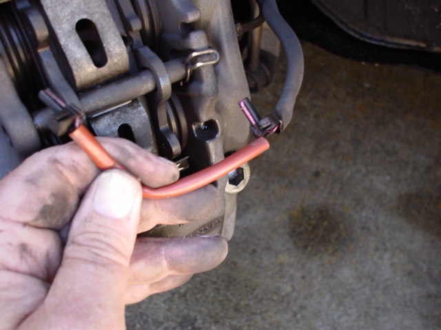

Some brake pads do not have the holes for the sensors, like Pagid. I used to take a cable tie and secure the sensors out of the way on the metal brake line. I recently cut them short and twiested them together and cramped an electircal connector on them. I was a little concerned about the tied up sensors rubing on wider tires I put in the front. Just seemed neater too.

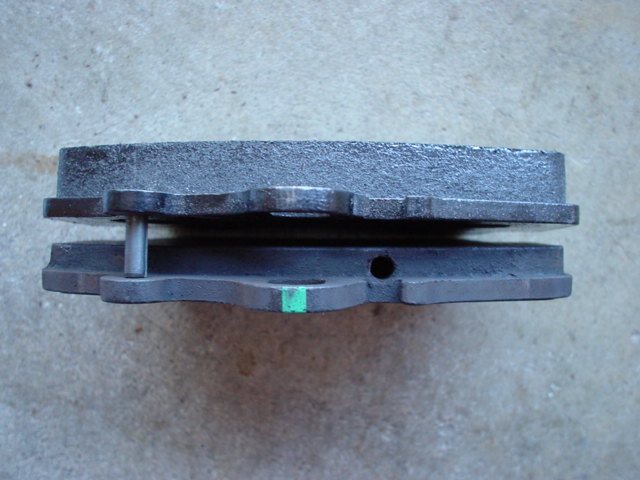

Anyone got alist of which brake vendors or models have the holes and which don't...or anyone got a short list tucked away in their brain...

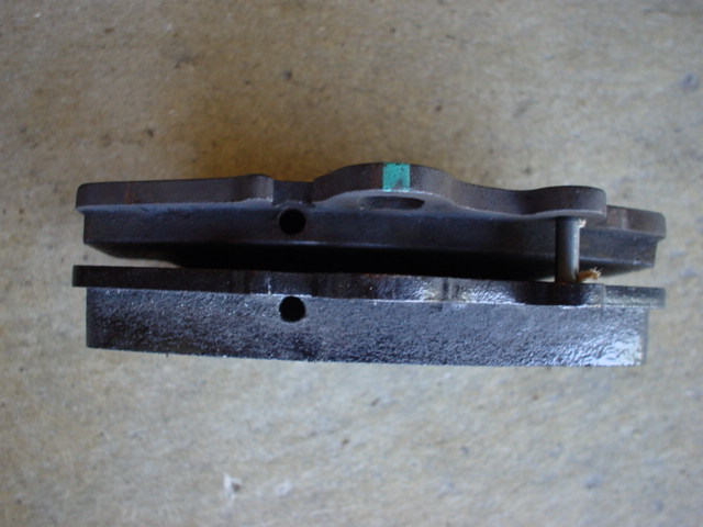

Just match up the hole in an old pad with a new pad that does not have a hole. In the pictures the new pad is the thicker one that I drilled the hole.
You are right, looks real easy and since the sensor is just on a wire one it appears one could be off a mm either way with no concerns.
Other then taking it slow is there any trick to drilling into the brake material?
Does it crumble easily?
I would guess that would depend on the make and content of the pad material.

I still don't understand how the sensors work. If they are caused by a break in continuity then how come they keep coming on and off and on again? I just did my brakes last nigth and they were 100% intact (the sensors) yet the light came on several times.

They are just a wire so if they come on and off then there is an intermittent connection or break in the wire.
That is the way I understood it from our last discussion but was just surprised under post replacment inspection that I didn't see it very easily. Obviously it's there.
