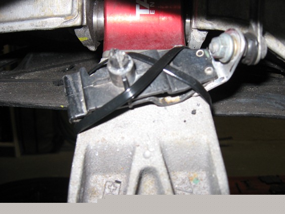

Yes, they are supposed to "snap" in. There are little tabs, and they are supposed to go into a spot on the control arms. .
There are actually two different types of controls arms for cars with and without lintronic. If for some reason you don't have the right control arms, or you want a down and dirty fix, you can use two wire ties. Make an X across the top. Holds just fine.
(Note in this image, the control arm is disconnected from the wheel carrier and is hanging down loose, making the sensor off kilter.)
