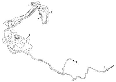

P0446 Below lower limit.
- Purge air line blocked.
- Flow resistance of EVAP canister too high.
1 - EVAP canister purge valve
2 - EVAP canister
3 - Purge air
4 - Tank
5 - Pressure sensor
6 - Shutoff valve
7 - Operating purge valve
8 - To intake manifold
9 - Vacuum control valve
Check purge air line for blockage.
1. Remove front right-hand wheel housing liner.
2. Detach purge air line (connection face up) from EVAP canister.
3. Blow through purge air line with compressed air.
