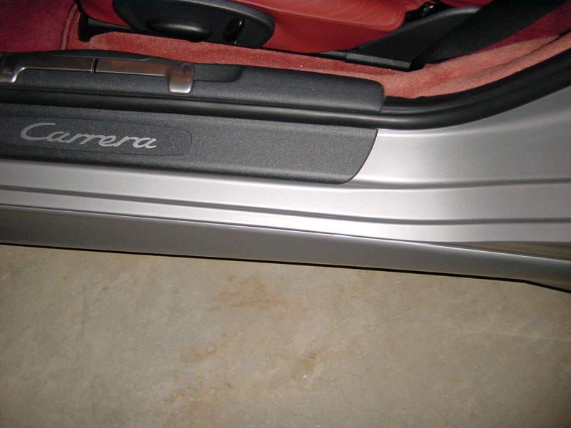

I'm getting a bit confused so I just wanted to confirm I'm explaining myself clearly, when the door is open and you look down at the sill there is a plastic over and inset in to it (in my 03S anyway) is a rounded rectangle/oval piece about 10" long that says "Boxster S". It is recessed in to the plastic door sill, I can get my fingers in the gap around it but don't want to risk pulling it (yet!).
I'm a little confused as you and Loren both said it wasn't recessed, I can try and take a picture later. In understood that in a C4S this panel may be illuminated too, hence why I thought there may be wiring access underneath it.
