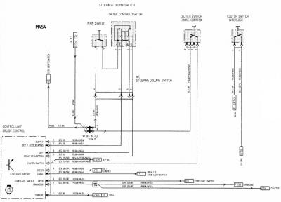

What does the other end connect to? Loren's diagram showed it connecting to the "CONTROL UNIT CRUISE CONTROL". Where is that located in the car? Maybe I accidentally disconnected that.

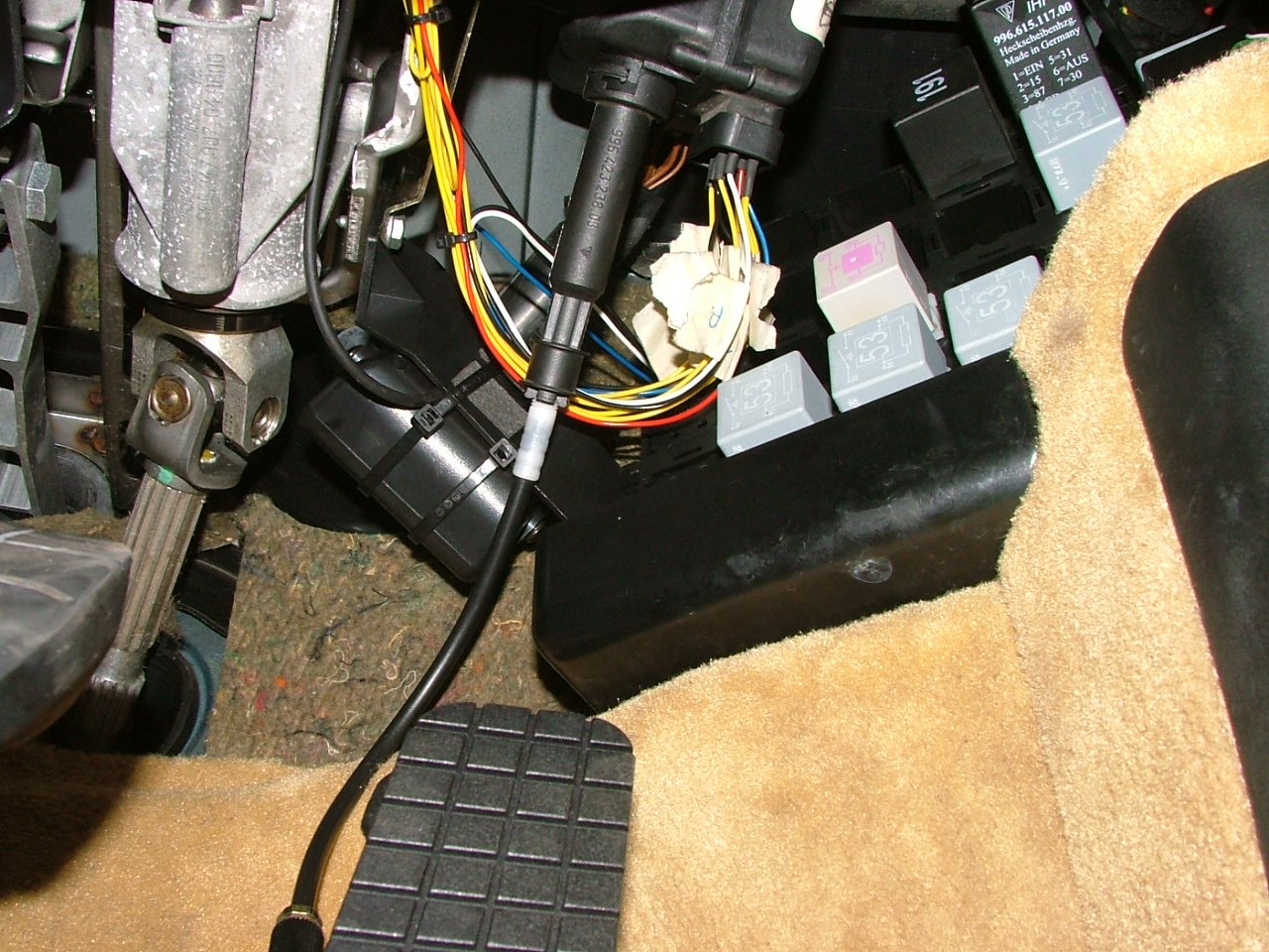

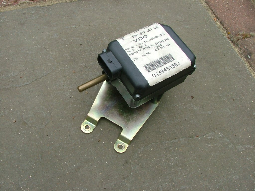

The actuator looks like this:
Bear in mind that this is for a RHD car so has an additional mounting bracket.
In a RHD car it fits like this:

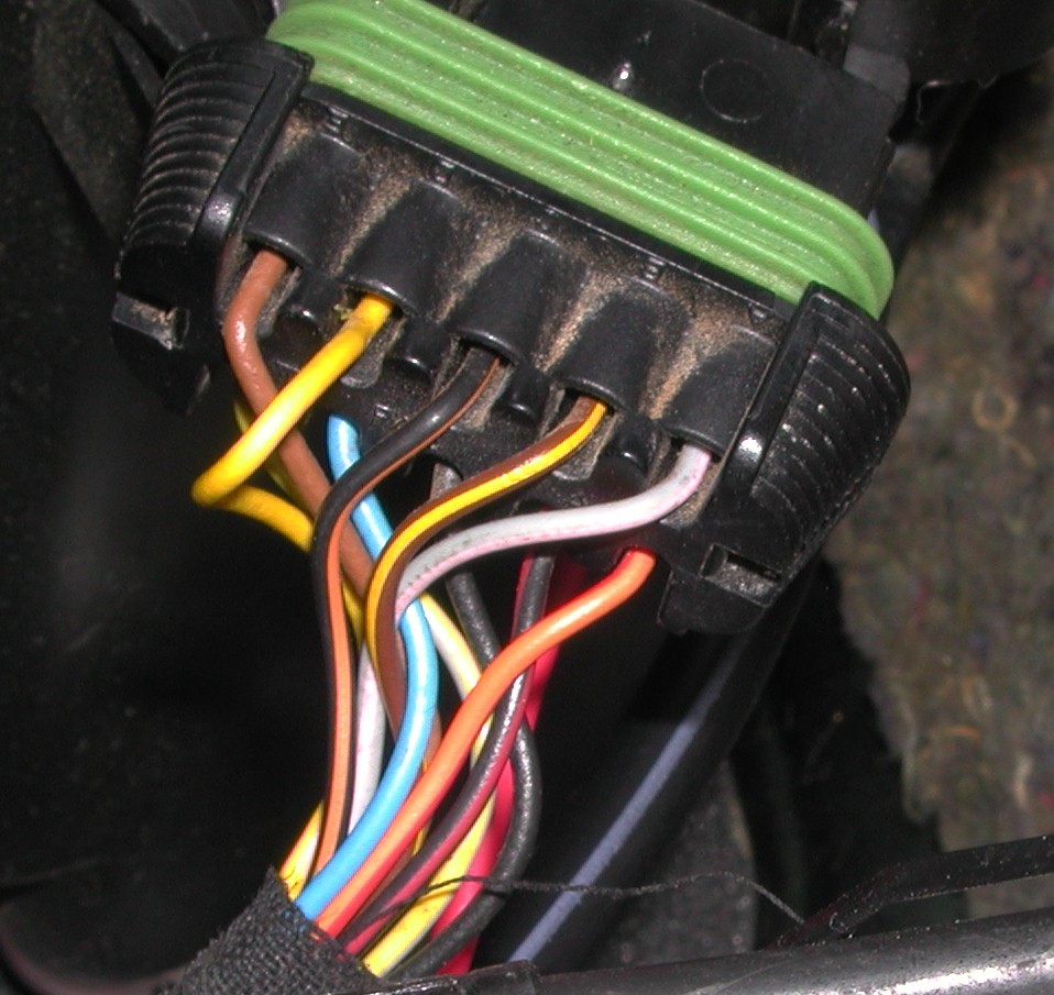

The wiring is temporary in this photo, you should have a plug on the end which looks like this:

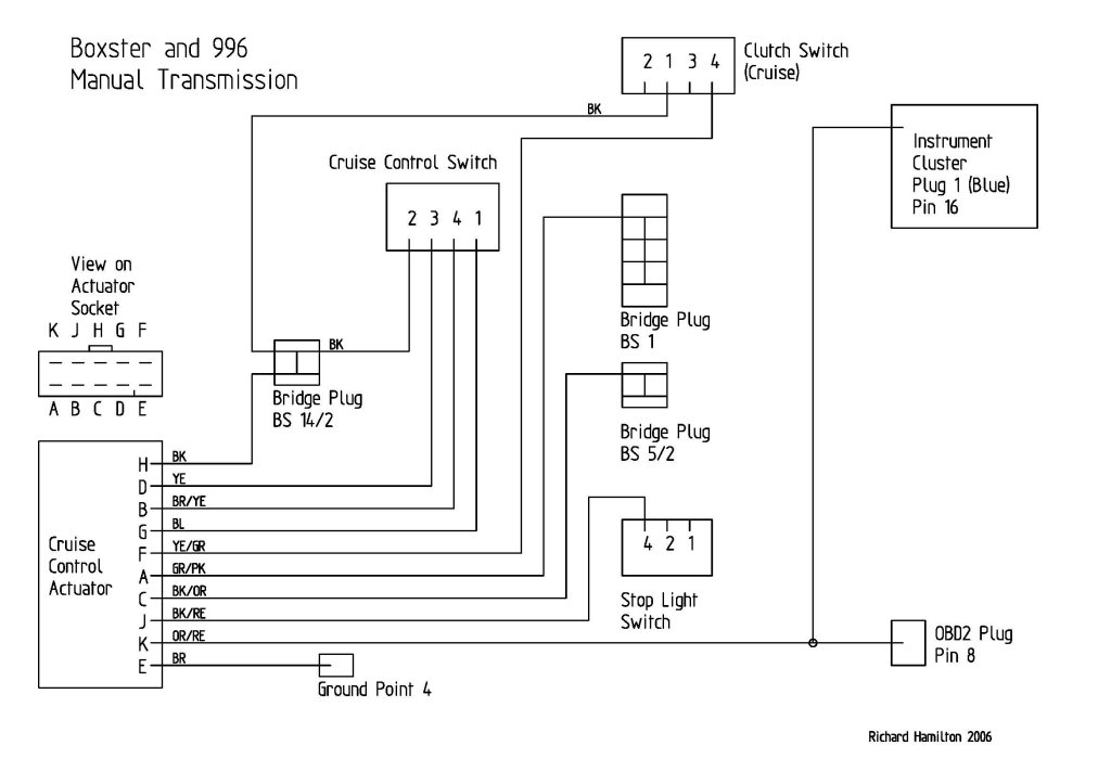

Here's a simplified wiring diagram:
It would be a hard job to disturb the plug connection. Other than that, I can only suggest checking all the other connections. I'm not sure if the PST2 will show the input signals on the cruise control module - maybe Loren could comment here.
