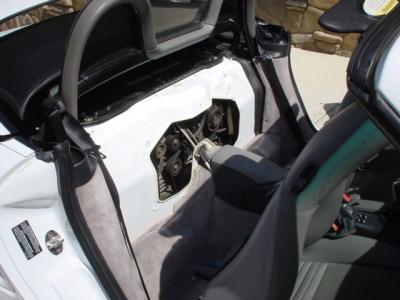

My '01 S w/ 47k makes a loud squeal right when the engine fires. It sounds a lot like bearing noise from an idler pulley. It goes away completely when the car is warm. Is there a way to examine the pulleys? I can't see anything from above and, while I have yet to get the car in the air, I don't think that looking from below is going to help much either. Any ideas? Are pulleys a known "issue" on these cars? Any help would be greatly appreciated. Thanks in advance
-Tom
'01 986 S
Remove the service cover from behind the seats and you can see everything. Don't know about your noise but the pulley bearings are known to go bad, also the water pump bearings, on 986/996. No clue as to why it would go away when the car is warm. Could be something else.
