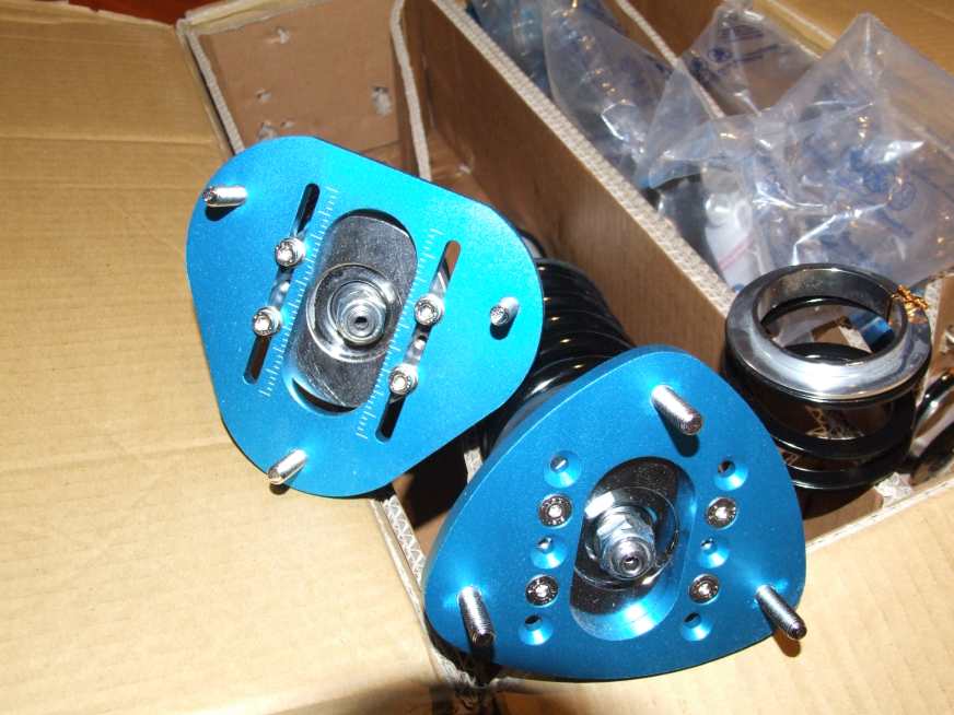

Just got these installed after my driver side front Bilstein gave up the ghost. Initial impression: geez, they are firm. Have to take speed humps a lot slower now. Cornering is definitely more sure footed. Although the whole exercise included changing the coilovers, replacing a slightly bent drop link, adding some better front tyres, and a wheel alignment. So I don't know how much impact each contributes to the cornering. Will test out the new setup more in the coming weeks.

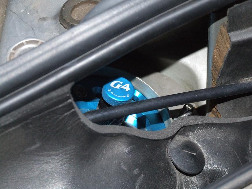

Well, after a month of driving, I find this setup fantastic!
It is still hard on the bum when going over speed humps, but the handling around corners is great. Very neutral, lots of grip. I don't think I have enjoyed my Boxster this much, ever.
The damper firmness is 24 way adjustable via a twisty knob.
On the hardest setting, you can definitely feel a lot more of the unevenness of the road - which gives you a bit of a headache when you drive for more than half an hour. But cornering on it makes you wonder, why is it still gripping? It should have no grip at this sort of speeds!
On the softest setting, you don't get headaches, which is great for long drives. You do get more body roll and the car seems more willing to slide, very neutrally, around the corner. I think this is the benefit of having a soft setting, and that is the car will give you a bit of warning that you are pushing too far, whereas on a hard setting, the car will probably just let go once the limit is reached.
All in all, I am very happy with this suspension setup. For the price (around 1300USD supplied and installed and wheels balanced and aligned), it is good value.

This is the picture I find most interesting.
http://www.renntech.org/forums/index.php?a...ost&id=6081
With the JIC (branded Cross in the US) setup I installed on my car, I have more rear camber than I want. These guys have actually understood this is a problem with lowered Boxsters and have made allowance for it by giving you 3 camber settings on the rear upper strut mount. Now why can't JIC and Bilstein do the same?
I'm going to have to look into what it would take to get something like that fabbed up.
