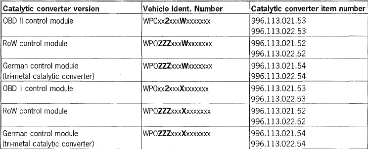

Hmm... in some cases the Euro OBD II specs are tighter than the US and they use different cats.

Select data record according to the allocation table and press the double arrow key [»].

My RoW car does not have O2 sensors after the cats - only before.
In the DME Control Module Programming option of the PST2 there are 4 options:
Read Out Control Unit.
Program Control Unit - this is for programming a new DME and goes through all the options (Map, Data and Immobiliser Code).
Map/Data.
Program Immobiliser Code.
As Loren shows (step 5) you should read out the control unit before installing a new DME module. Reading out the control units doesn't allow you to see what options are selected, unfortunately. I think (and emphasize "think") that this process stores the data of the old DME, so that when you fit the new one it will have recorded the settings for the new one, allowing you to choose them by default in the programming step choices.
My suggestion would be that you read out the control unit, and then try and reprogram the map/data. I have a feeling that it will default the programming steps to the settings that are stored when the data is read out. This might confirm that the right cat settings have been made. Worth a try, perhaps.
