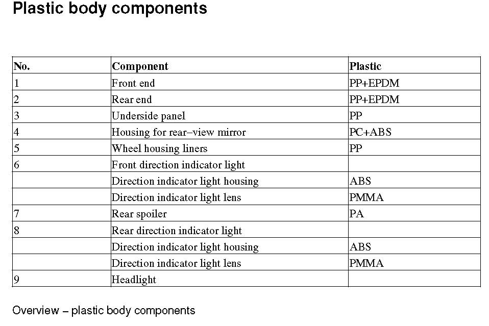

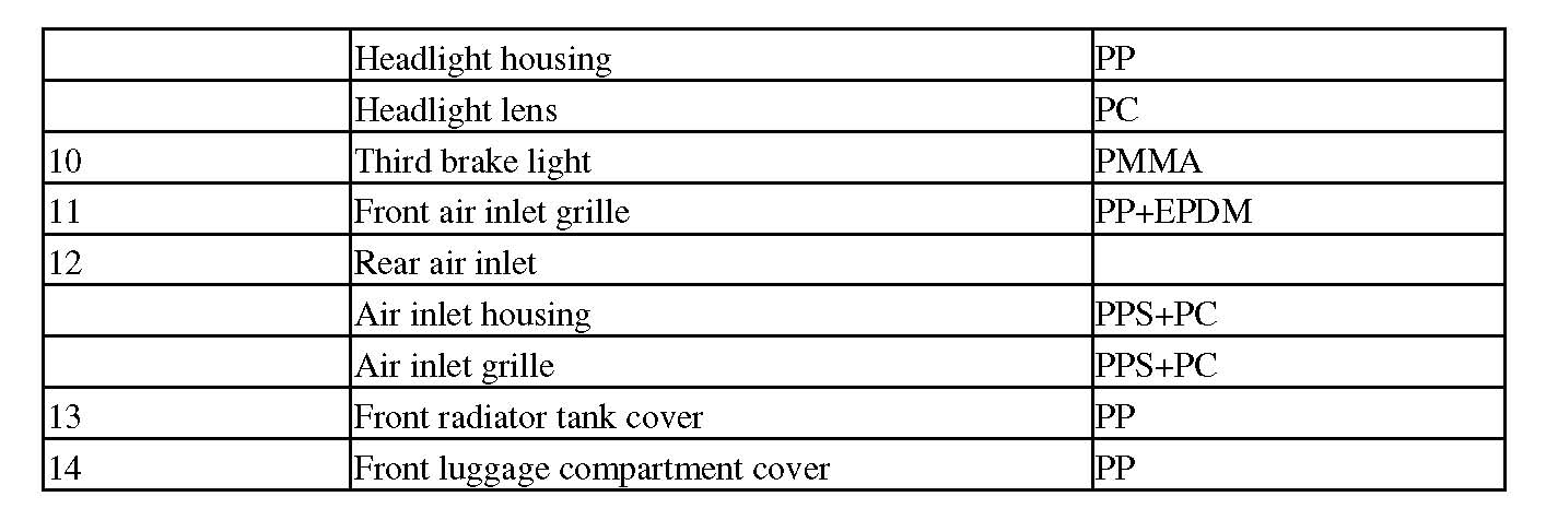

AFAIK,
Generically it is a type of polyurathane, commonly used in most late model cars. Porsche may use a specific formula... might be tough to find out exactly the composition though.
According to someone at porsche he looked at a bumper and it said: <PP+EPDM P20>
PP could be but EPDM is a sort rubber so I'm not sure about the PP either!
What do you guys think about PP?
To be honest I was more think of PU like you!
