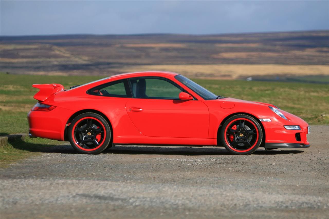

pic with new black lip

one (I want to preserve) seems alot stiffer and also painted and clearcoated. I will try yanking carefully from either side towards the middle-BTW Love the way the black lip looks on your red car.
