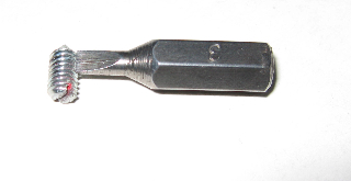

Photo of the screw that needs to be loosened (theres 2 of them)
The number 3 bit gives an idea of the size bit or driver you need
Note the red sealer in the slot of the screw, this needs to scrapped of so you can loosen the screw, it can be difficult to scrap it out of the slot of the head of the screw so a screw driver will fit and also to get it out of the thread, as mentioned in this thread , a liitle solvent on a a cotton bud may help

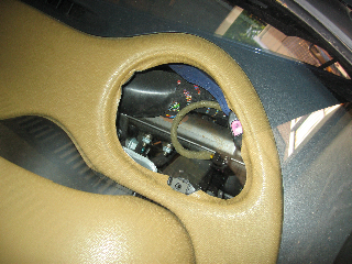

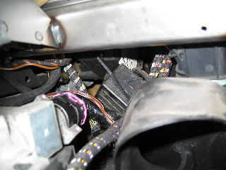

ignition switch viewed through vent, the switch is in front of the pink connector
its a 2 minute job to take this out, it allows a good view of the ignition switch screws when scrapping the red sealer off, this is if you choose the method of removing the side vent, its more involved and requires the removal of more ducting but you may need to use this appproach if you cant loosen the screws, Take it gentle with the side vent as there are a couple of plastic levers that pop off easily and stop the vents from moving
