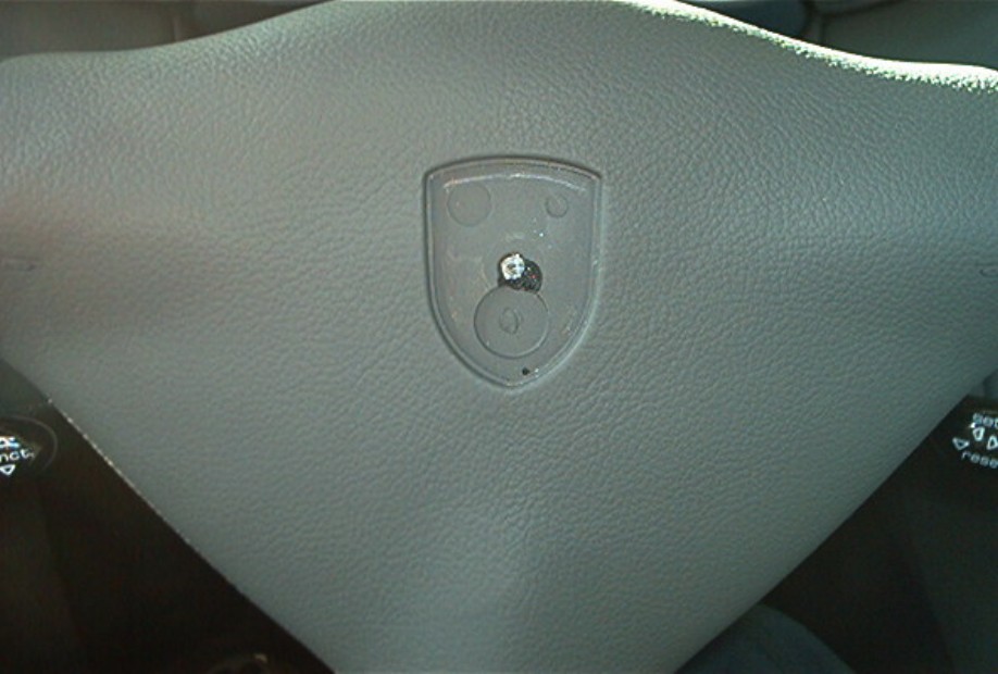

It is riveted on and is not meant to be removed. It would become a projectile aimed at your head if it were not....which leads to the question...why would you put a stick-on on the airbag cover? are you asking for trouble? Loren has a better idea...trade your silver for a colored one from another owner.
As stated above, find someone to swap air bags with.
You would have to remove the cover and grind off the back of the rivet, or drill through the face of the crest. This is not a standard DIYer project.
I forget where this picture came from.
