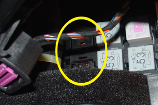

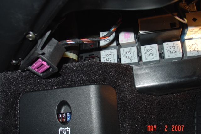

The latest PET for 986 and 996 do not seem to identify these relays; if they do, I am totally missing it. So, I have a couple shots below of my relay block, under the left side (US driver's) dash. There are two blank spots (coincidence, perhaps) on the left side of the block--what is supposed to go there? More to the point, does anyone with a relay block diagram (for an '03 986, or thereabouts) have any footwell lighting circuitry that can shed some light (pun intended) on the part numbers and physical location for these relays?

Those spots don't look empty....they look like they have shorting plugs in them. Empty relay sockets will have an actual hole. See my post in the DIY section regarding PSE wiring. When I installed that relay socket, the relay, and the wiring, I used one of the open "holes" on the relay carrier. If you remove the relay carrier, you'll see the shorting plugs have lots of similar-colored wires running to them. Things like speedometer output, grounds, and LED lighting share common shorting plugs. You definitely don't want to pop out one of the shorting plugs!

So these spots (circled, below) have a shorting plug in them? There were some true blanks/holes in the relay block (that you can't see in any of my photos), so that makes sense to me now.
