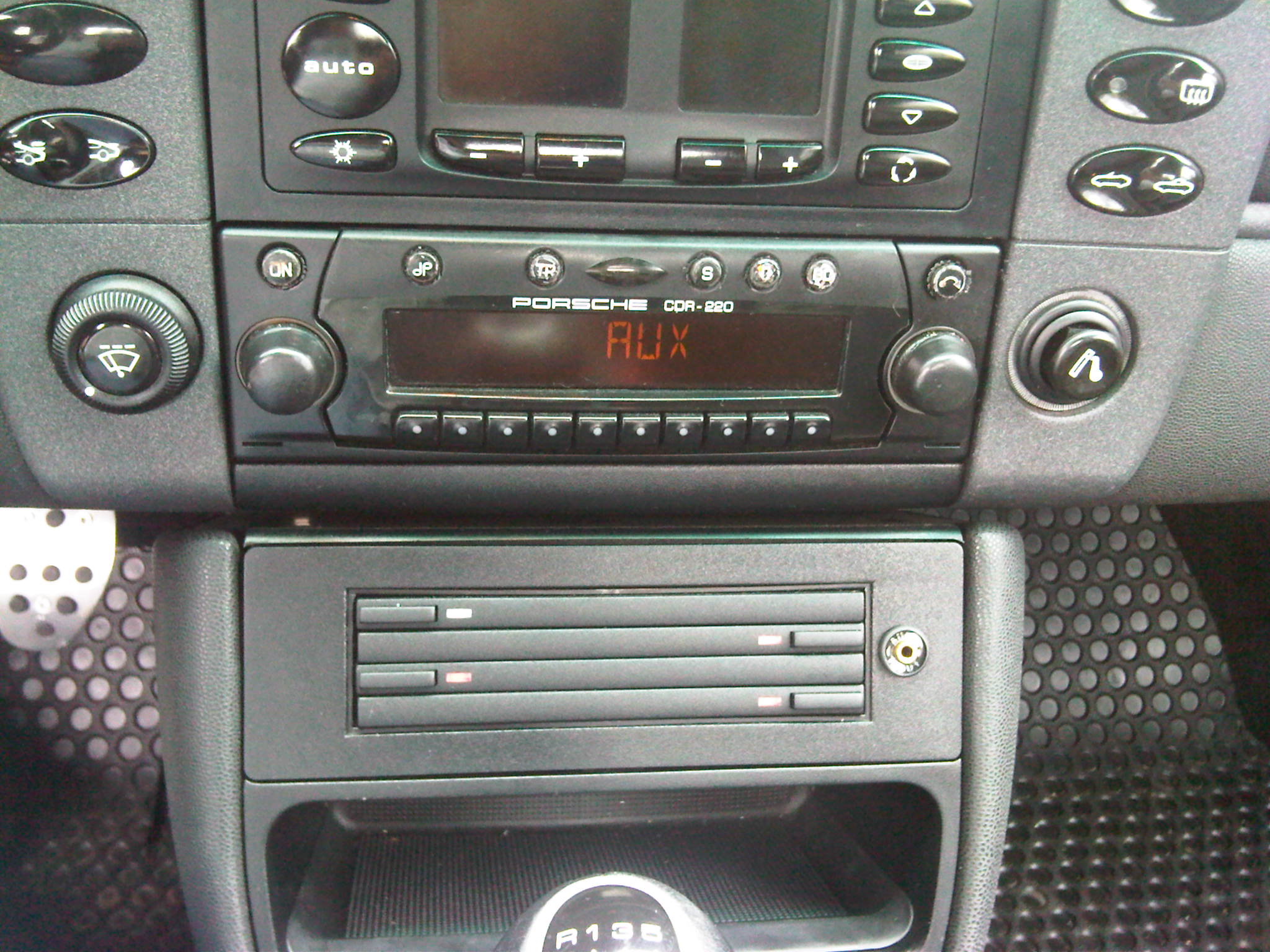

Keep in mind I bought a Solisto Extra for my Nav PSM1 headunit...they make also make one for a 220 and/or many other Porsche OEM radios. Here are a couple of pics so you see what I am talking about. I'll add more when I have more time. Basically you should checkout the website URL I posted earlier.
BTY: I installed mine in the fornt boot in the same location as the CD changer with the cable pictured. You can also purchase a cable that connects directly to the head unit, then run the line and install the box in your armrest, then attach your iPod... Again, it's very easy!!!
I paid 99 Euro for the Solisto Extra and 14.99 Euro for the cable. This is a special holiday price.
Good luck! Let me know if you need anything else.
Aloha, 808C4

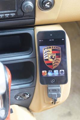

I have an iPod Touch 4G connected to my Becker 220, using a cable from Becker Sound. It's a single cable which also charges the iPod. The sound is excellent - no distortion or interference of any kind. I was surprised at the $110 price tag, but I believe this is the only option available (for 4G) and it works great. I highly recommend it.
Edited by wyovino
I have the Becker CDR220 as well and an iPod Touch 4g. I went with the Becker Sound cable and am very pleased with the results. It's one wire, not a bundle of RCA plugs. It charges the unit as well. Most other solutions will not work with 4G as the electrical requirements are different.
