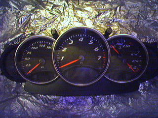

Clock Dial
They dont come off, they look like they do but they dont, they are one with the cluster, but they have a 1 millimeter cut-out trim around each ring that give the illusion that they are, but they arent, i painted mine also and had to mask everything off, even the plastic lense which is difficult cause any wrinkle in the tape where the ring meets the lense and you might get paint on the lense
