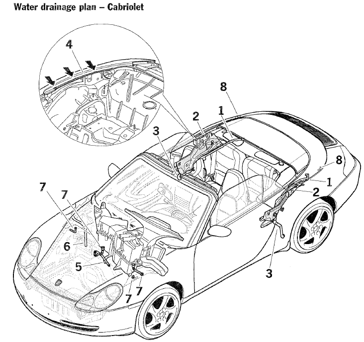

I found the source of the leak. Pic is attached of the area under the passenger side dashboard (US). You can see drops of water coming from a quarter-size part with a gold screw in the center. I removed the screw and then tightened it back but the water still leaks from that are, especially with the A/C running. It appears to me that a gasket or something should be there. Can anyone confirm that????

I think the leaking "gasket" may be secondary to the main problem - item #7 in Loren's drawing is probably stopped up below the junction of the A/C condensation drain.
Have you checked the passenger side drain under the hood for blockage? If not, remove the plastic covers over the battery and each side. Peek into the pasender side drain pan located to the front and right of the pollen filter and and look for a 1" rubber grommeted hole. Is it clear of leaves, etc.? If not, pull out all the debris and pour a pint of water into the area and see if it pours out freely under the front passenger side of the car.
If the water doesn't drain freely then you probably have one or more obstuctions inside the drain tube. I cleared mine by blowing the clogs out with compresed air. The backed up water acted as a plunger and shot a pile of crud to the ground. After that, the interior stopped smelling like wet dog and I've been trouble free since.
FWIW - I check both dash drain holes every six months as they tend to accumulate seed pods in the Spring and leaves every Fall.
Good luck and let us know what you find.
