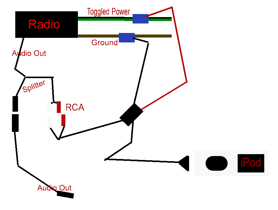

Second, I have decided to hard wire the iPod in with two input sources. The diagram below explains what I want to do. My question is: Do I hard wire the power into the cables coming out the back of the radio that are woven together? If not, what do I wire the power to that is toggled with the ignition?
Also, can a headphone splitter be used both ways, to take two inputs to one output?
Thanks! :)
First, the setup would like to do. (sorry, I am no artist, and note the white RCA plugs, and iPod outline that are cut out by a white background.

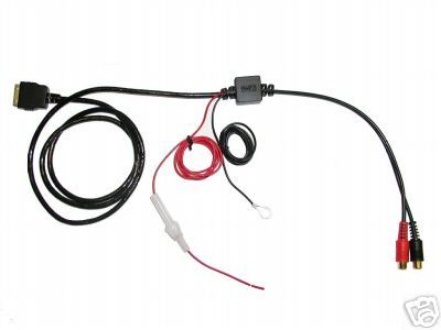

Second, the cable I would like to use.

1. what radio do you have? (CDR-220, etc?)
2. what year is your car?
3. have you searched here for 'iPod'? there is tons of info.
i think the blue wire is the phone mute wire which (in a factory setup) will mute the stereo when the phone rings.
depending on which model year your car is, there is a 3- or 4-plug extra power plug located behind/under/around the stereo. it's just a loose wire with a plug on the end. if you search for 'iPod' you will find a diagram that shows the power plug and what the wire colors correspond to. one is switched (toggled) power, one is constant power, one is ground, and i can't remember what the other one is (phone mute maybe.)
