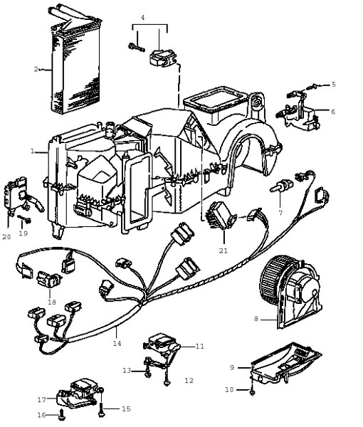

i found a schematic of the system, but there don't seem to be any part numbers for the mixing doors. are they shown on here?
