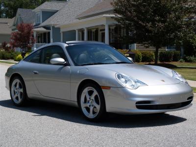

My car:
2003 996 Targa 6spd
Arctic silver on supple full black leather
