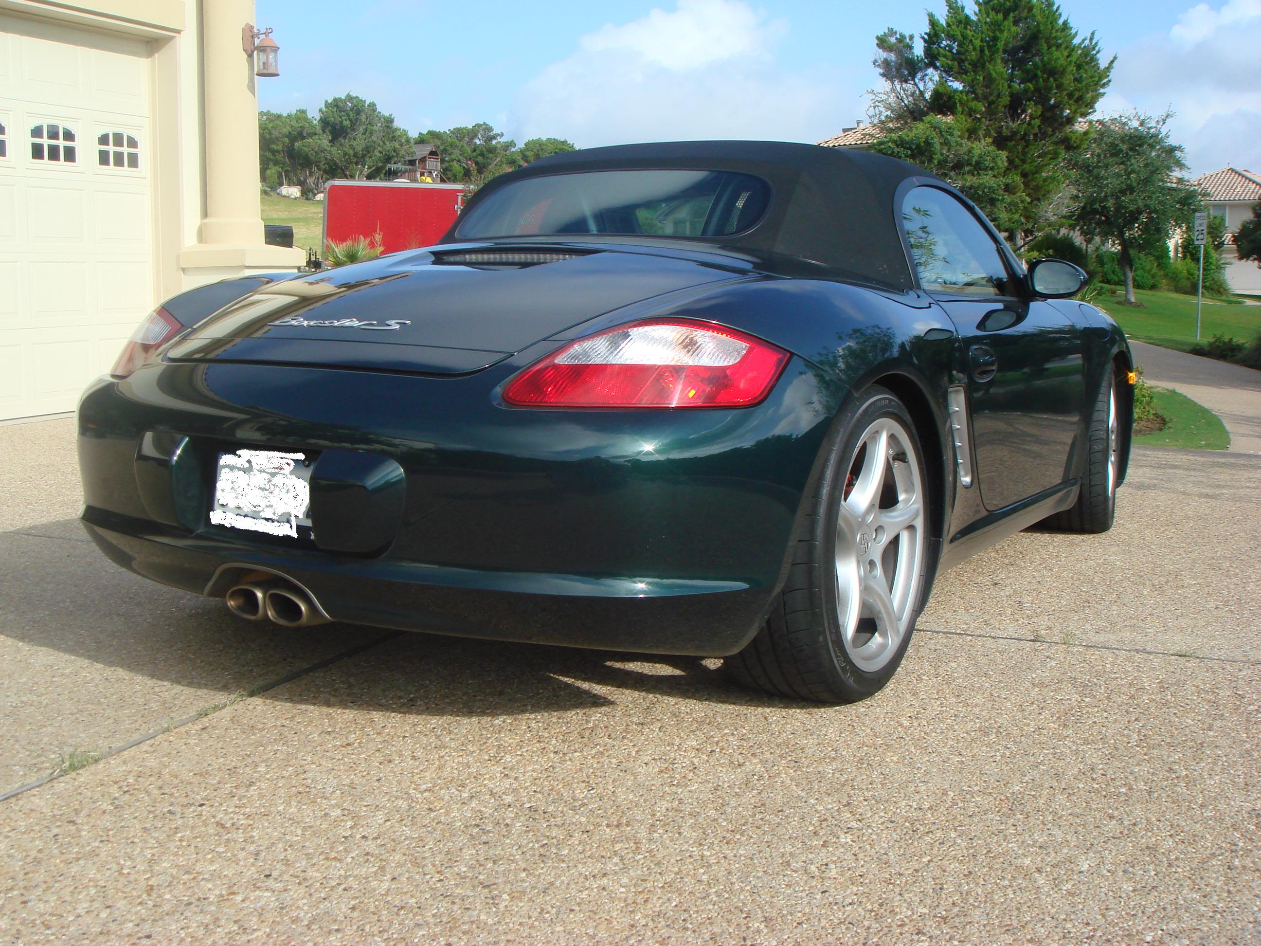

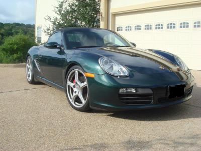

I bought some track wheels. The spacers came with the rear wheels and were required to clear the rear strut. I installed them for use on the track and left them on for use on the street. They work just fine in both cases. Cosmetically, I think the fronts look fine without a spacer, but that's just me. Longer bolts were part of the deal and you cannot use the stock wheel locks at all.
I've attached a quick pic I took to give you an idea of what to expect.
The offset of the 19's is 46 in the rear and 57 in the front if I have that right.
Nestor
Edited by nfesas

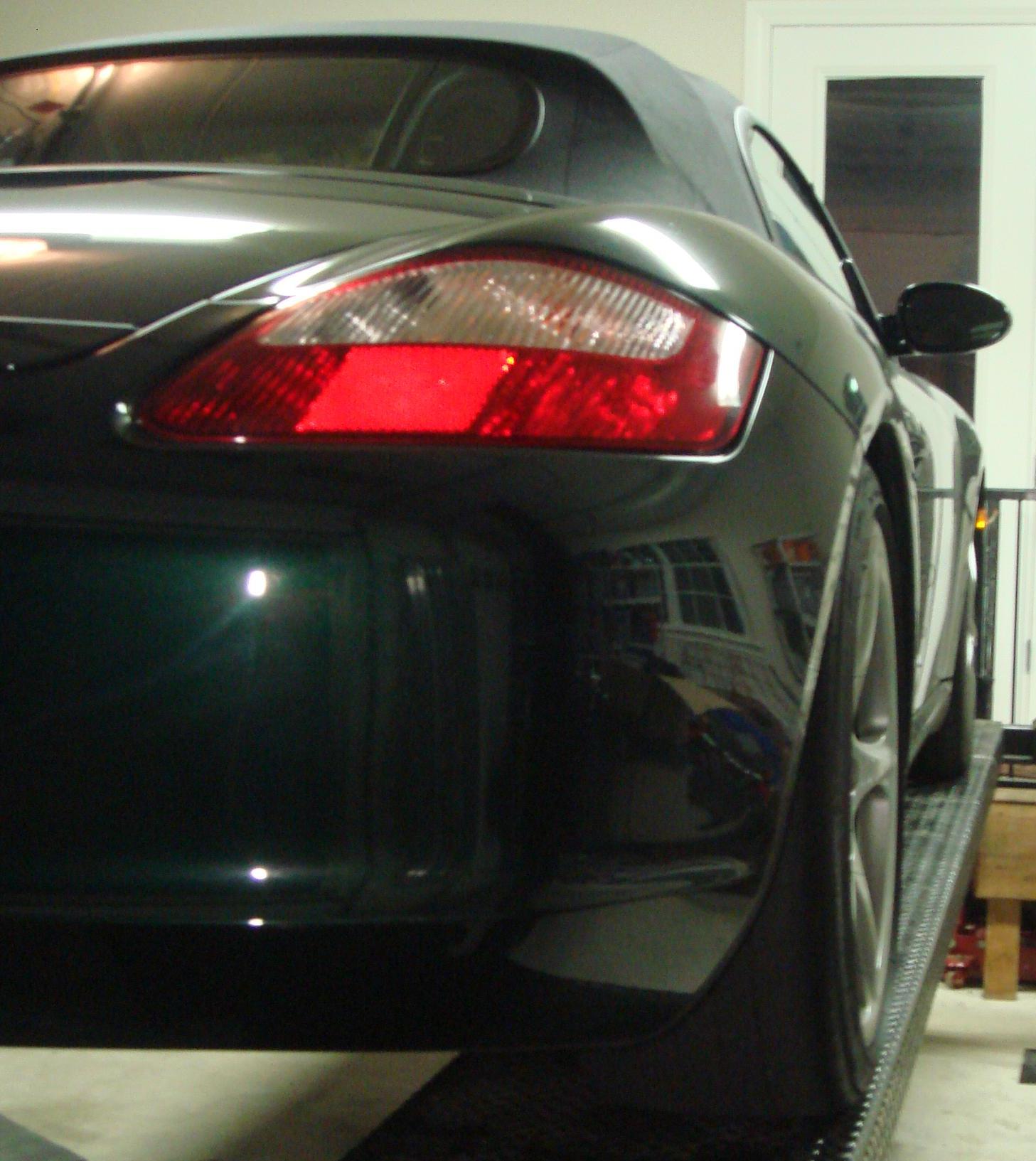

Thanks, Nestor, looks really nice and flush. My offset in the rear is 43 (standard 18" Boxster S wheels) so I should be ok with similar spacers but I can not believe it would clear the fenders. I measured and it looks like I could only go out another 1/2" or less. Your rears look like they are a bit far outside as well. What made you sure that they would fit? I don't want to find out when my sidewalls are all worn out. Maybe you can tell a bit more from the pic.
When I lowered my car, I ended up with more negative camber than the factory specs. I didn't know the spacers would work. I figured they probably would since many others have done the same thing and I had more negative camber than the factory setup. My rear camber is currently set at -2 deg. This causes the tops of the wheels to tilt in towards the center of the car. I don't have any rubbing with either my factory wheels, shown in the pictures above or my 18" tack wheels. I'll post a picture or two of the track setup so you see what I mean. YMMV as each car is unique given the manufacturing tolerances.
Also note that as the rear suspension works through its radius, e.g. on bump, the camber will go more negative than the static setting. So in essence, you'll have a little more room to play with as the wheel goes deeper into the wheel well - to an extent.

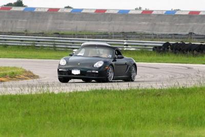

Here's a picture of the car on a high speed right hander at Texas World Speedway. You can see that the outside tires are relatively deep into the well. No rubbing at the track or on the street.
Nes
Thanks, Nes, the effect is clearly visible. I thought I needed to be on the safe side. What amazes me is that it still works with the standard wheels. I'll probably get it set up at max negative camber and check the clearance again. Did you see a difference in handling due to the different track width rear/front since you didn't do the fronts?
