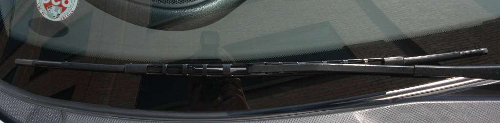

Well, that answers that question. But for academic purposes, this is what I meant by straight vs. curved:
Straight (driver's side):
Curved (passenger's side):
How much handling prowess do you think is lost in making the switch to a straight blade on the passenger side, and do you think it can be made up by installing a front strut tower brace?
In all seriousness, though, do you have to select a shorter passenger side blade to avoid it hitting the plastic trim at the base of the wideshield, on the lower right in the photo above?

This is a better picture. The curved passenger side is on top.
I have seen cars with aftermarket straight blades. I can't see how it would matter. I just happen to notice these things....
