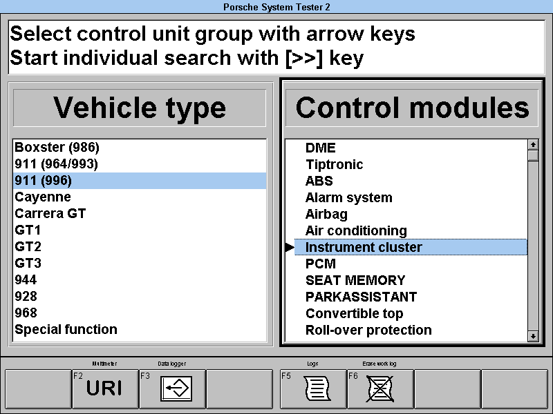

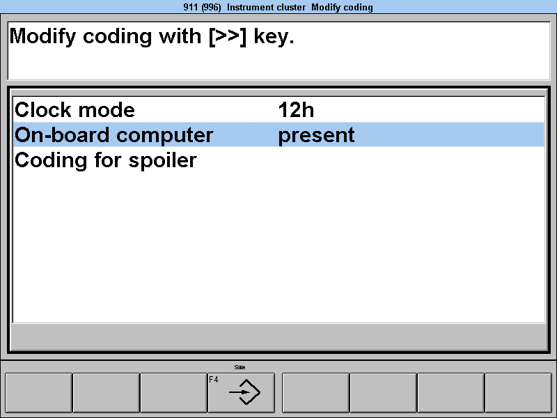

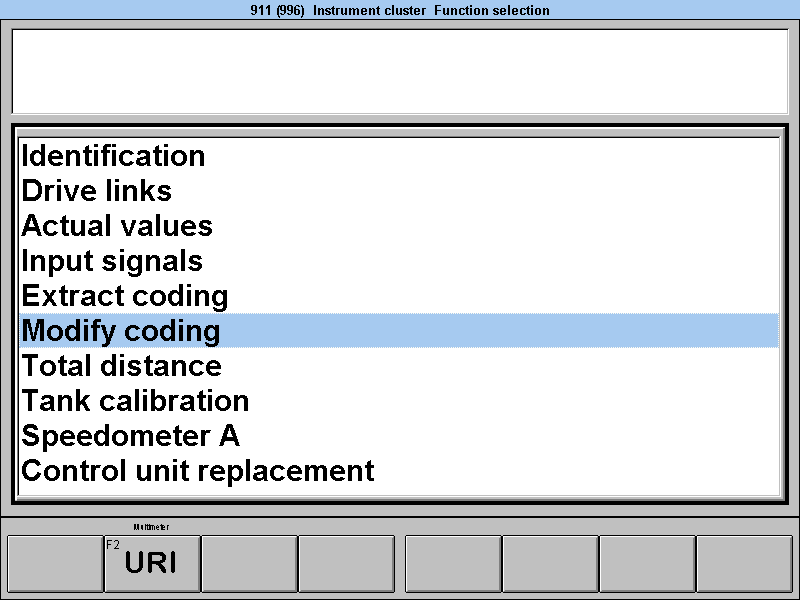

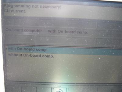

Yes, in about 2 minutes with a PST2 or PIWIS.

Yes. These are pictures of a 1999 C2 where I turned on the OBC at a local work on cars day in July. Also turned it on for a 1998 Boxster at the same work on cars day. Same procedure.
