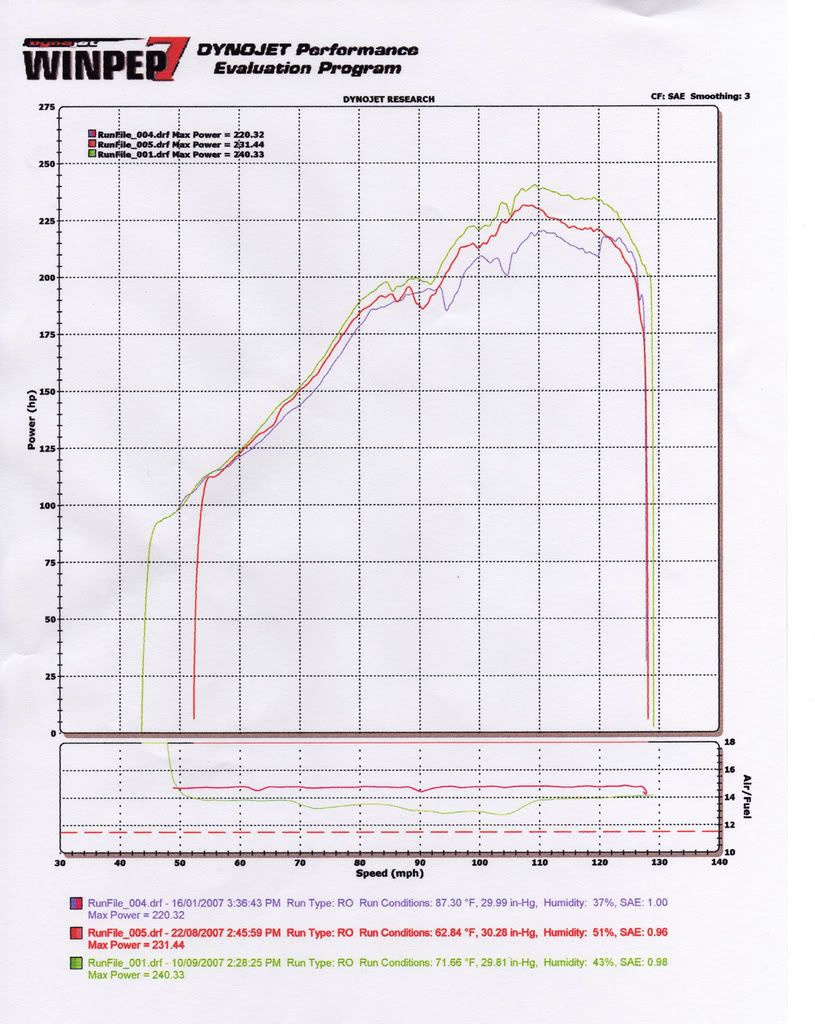

Dynoed my 2000 Boxster S before and after with eBay 4 into 1 aftermarket headers. Here is the graph.

The blue curve is the stock run, 4th gear. Didn't bother to open up the engine compartment so no rpm readings.
As you can see at higher speed(=rpm) there are many inconsistent dips on the graph this is where I expect an aftermarket headers would improve over stock headers. Im also interested to hear what do you think the cause of these "dips" might be?
Red is aftermarket headers with stock exhaust.
Other than the different room temperature and humidity, I tried my best to keep everything else constant. Same type of fuel, same set of tyres with the same tyre pressure. I don't drive the car much so there were minimal tyre wear (about 2000kms of 80% highway driving).

Down low below 65mph you had about a 5hp gain across the board, then it looks like at about 85mph variocam kicked in and there is a drop which is normal for any variable camed engine (VTEC MIVEC ETC), then the gains really started to pile on. You have an almost 25hp gain at 105mph which would be around the 6000-6300rpm mark by the looks of the graph. Pretty impressive. You got the power in the top of the band which is exactly where you want it if you like to go fast. The gains down low are pretty useless.
I'm actually surprised they did that well. The headers did quite well on the 2.5 because they don't have a collector built into the header, where the 2.7 and 3.2 both do. Even though there is a cat there, the existence of some type of collector is going to make more power vs. not having one. You still made great power on top of that.
Thanks I was wondering about why the irregular drop. This is actually my first N/A car with variable cams. The car definitely feels more alive above 4000rpm now. Do you know at what rpm does the variocam normally kick in?

I've actually got the Euro spec Boxster S (Im in Australia BTW) which has no cats integrated in the headers so it made the job much simpler.
Overall Im quite surprised with the actual gain from these headers as you said "almost 25hp at 105mph". Very happy with it.

looks like another solid gain with the GIAC! did you consider any other programming options? was this program specifically made for your car and its modifications or just the year and model?

Matt. It's the standard Giac software for 2000-2004 Boxster S.
My driving imperssions are that the car feels smoother on acceleration and power delivery is more linear. The engine feels more free-reving (especially from around 4000rpm). I can definitely feel a big difference as I have already driven the car in stock from for a few years so it's easier for me to pick up any improvements. These two mods in my opinion are the most cost effective enhancements for a Boxster consider the relative low cost (headers) and ease of installation (both) compared to say, an evo cold air intake or an aftermarket muffler.
