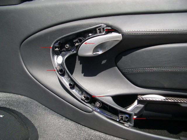

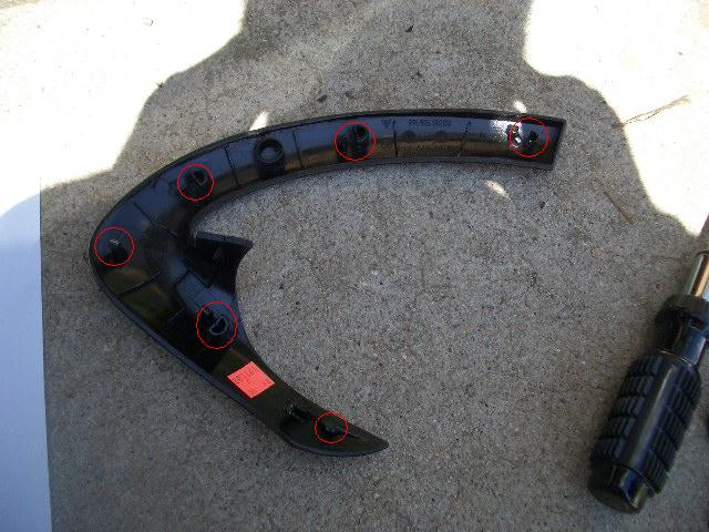

The door handle cover clips were different than what is shown in the DIY instructions. Instead of having 2 clips, the cover has clips in 5 places, and has alignment posts/recepticles to line things up (a design improvement, I think):
