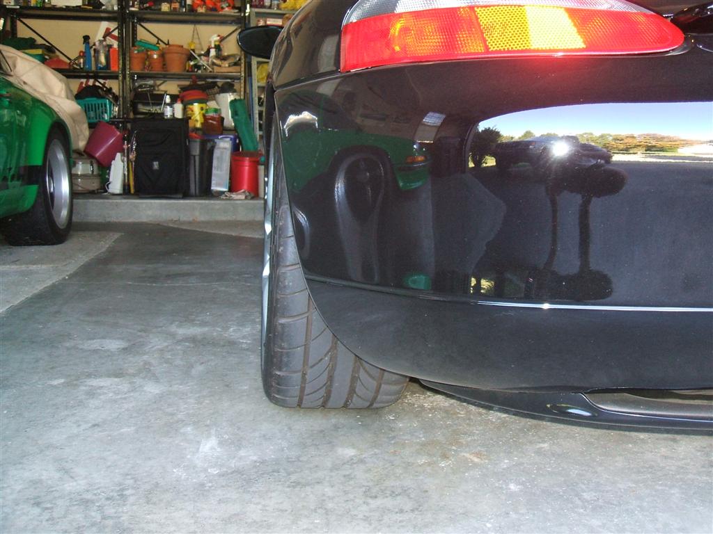

I recently installed some Gemballa lowering springs on my 2000 Boxster S. I let the car settle out for a couple weeks and did some light driving. As expected the alignment was all screwed up. So I got it aligned last Friday. Here's the best they could do on camber, caster, and toe:
Front
Camber -1.0 left, -0.7 right
Caster 7.7 left, 7.5 right
Toe 1/32 left, 0 right
Rear
Camber -2.5 left, -2.4 right
Toe 1/32 left, 1/32 right
The car now tracks straight with the steering wheel straight (didn't before) and everything feels fine. I'm disappointed in the rear camber though. It still seems too negative to me and doesn't look good. I have very little experience with alignments though. Folks at the PCA tour this weekend said the same thing though - way too much negative rear camber. I think they put the priority on getting the rear toe good and then let the camber fall where it did.
So what do you guys think? Is this a good final alignment setup or did they do a poor job? The work is guaranteed for 30 days...

You are correct in that the rear negative camber is set too high. Spec for your car is -1.3 ( +/- .3). Looks like you are a full degree out of nominal settings each side.

No, that isn't a stupid question at all! You are right that it would be difficult, if not impossible without camber plates, to get the car back to the stock settings once lowered. That's why I gave the alignment tech the ROW sport settings from Porsche. The ROW sport setup is 20 mm lower in the front and 10 mm lower in the rear than our US standard setup. I thought this would be a more obtainable goal to reach for with my car lowered 25 mm front and rear. Still I'm about a degree more negative in camber in the rear, even with using these specs.
I have H&R sport springs on my '02 S...I run 2.5* negative camber in the rear, as well; fronts are about 1.25* negative. It's a bit aggressive for the street, but the tires will turn to hockey pucks before I wear them out. The negative camber looks good to me as I'm used to running alot of negative camber on my 911s.

Just as a follow up, yesterday I took my car back to the tire/wheel shop that did my alignment. The work was still under a 30 day warranty. I had to fight with them a little to get them to see what they could do on improving the rear camber. They ended up working on it another 1.5 hours and got the rear camber down from -2.5 to -2.0. I think that's probably the best they can do without camber plates. I'll run it this way and just see what happens to my tire wear. Looking at it from the rear it still looks like it has a lot of negative camber. If the tire wear is bad I'll make sure to get some camber plates and get it realigned when I get new tires.
I've got Kuhmo tires on there now, which aren't bad. But I'm just waiting for them to wear out so I can replace them with PS2 tires. My understanding though is that the PS2's are pretty expensive, so if I do have an issue with tire wear, I'll make sure to get it resolved before I put these on.

I have my '03 with ROW M030 set as follows:
Camber F -1.2 degrees both sides
Camber R -2.0 degrees both sides
Front toe 1/32
Rear toe 1/32
Great street/track setup. On the street, the car drives like it has claws, it just plants and rails around the twisties and switchbacks, and doesn't railroad track much at all. However, I only drive mine a few thousand miles a year, so I can't say how tire wear will be. I don't really care because, I'm not worried if I have to put a set of tires on every few years. Haven't got it on a track yet, but I'm dying to.
