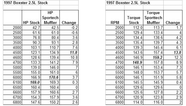

Below you'll find a dyno chart for a hacked muffler. I'm just curious what they exactly did to it, since it's quite an improvement, especially the torque.

Oh wow, so someone did dyno test it... Sweet!
...Below you'll find a dyno chart for a hacked muffler. I'm just curious what they exactly did to it, since it's quite an improvement, especially the torque...
-- peer
That’s kina significant, this was with a hack? Wonder how it's done. I like the idea of a cut out so you don't always have to bum the neighbors out. Wonder how the PSE stacks up against it?

I would be very skeptical of a chart like this. It is essential to list the exact configuration that was tested as well as the ambient conditions in both tests. Additionally, a proper test is to take the median of a series of tests not to list the best looking single result obtained under optimal conditions.
Without this information these numbers are meaningless at best and misleading at worst.
The muffler is not the limiting factor on the stock 2.5L Boxster so replacing it will not increase horsepower or torque.

And how do you know this? Perhaps by doing the afore mentioned test of taking "the median of a series of tests"...?
