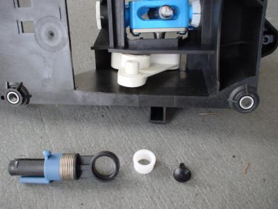

I installed a B&M shifter in my 2002 C4S a couple of months ago. Yesterday, while putting the car in reverse, something came loose and there was a lot of side to side movement of the shifter while in gear. I was still able to shift though. Today I took everything apart and found the problem.
There are 2 cables going to the shifter, blue and white. The white one has a ball pivot that snaps into the shifter. The blue one simply has a round base that attaches to the shifter. There is a washer that goes on here as well. The thing I can't figure out is what is supposed to keep the blue cable in place with the shifter? The washer (pictured below) had come off of mine, and I can put it back in, but is there supposed to be something there (like a nut or something) that prevents it from slipping off the shifter cable?
I know this is kinda confusing, so please see pics below. In the second pic, the blue cable is connected to the white "stub" coming off the shifter base. How does this stay on without slipping off the side?

ok, someone has figured out the piece that's missing which should hold these 2 parts together. It's not available from the dealer without ordering the entire shifter housing, so I don't want to do that. Can anyone think of any ideas for holding these 2 parts together? What if I simply glued them together? Do they need to be able to rotate or anything? Please see link below for the part that SHOULD be there.
http://forums.rennlist.com/rennforums/atta...mp;d=1191525592
this is the piece from the shifter that is supposed to go into the link cables.
this is the linkage connected to the shifter, but not secured in anyway to the shifter (this is what i'm trying to figure out how it should be secured)
this is the washer that goes in between the linkage and the shifter.

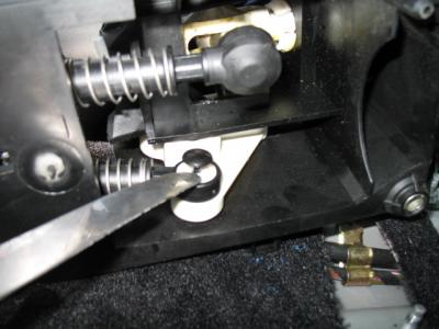

I had a quick look through the pics i took of my install and managed to spot this. You'll have to zoom into it a bit but it shows a large plug that seems to hold the whole thing in tightly. Maybe it will help for the time being, but if you need any further pics of the same thing let me know.
Regards
Popolou

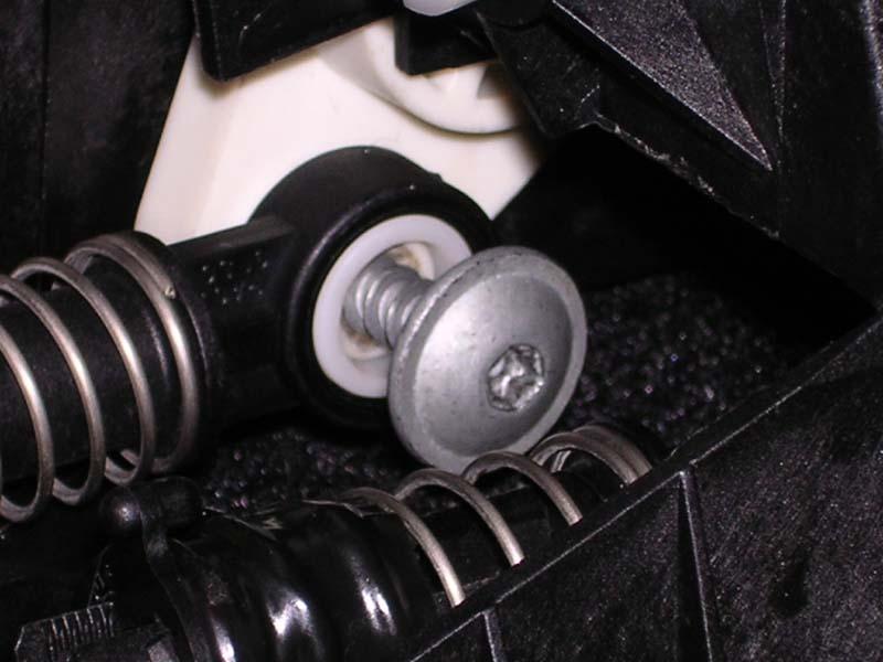

That round white plastic bushing in your hand is held in place with a black plastic plug with a barb on the end. If you did the short shifter install the Porsche way then you had to remove the black plastic plug in order to remove the spring-loaded cable connector.
If you cannot find the plug then you can use a screw. (pic from Evan.) The screw is not screwed all the way in yet in the picture.
