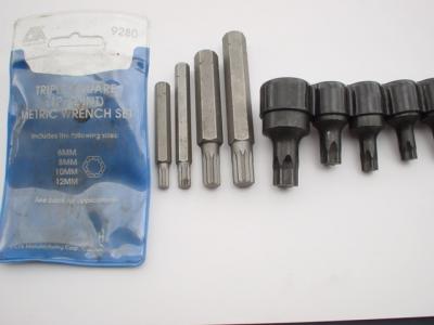

That might be a set like the one on the left, just the bits. Need to put a socket on the end of the bits. That is my old set which I bought 20 years ago because my Fiat had triple square bolts on the cv joints.
If you look at your door striker and door stay. triple square is also used there.
Black bits on the right are torx which have 6 points.

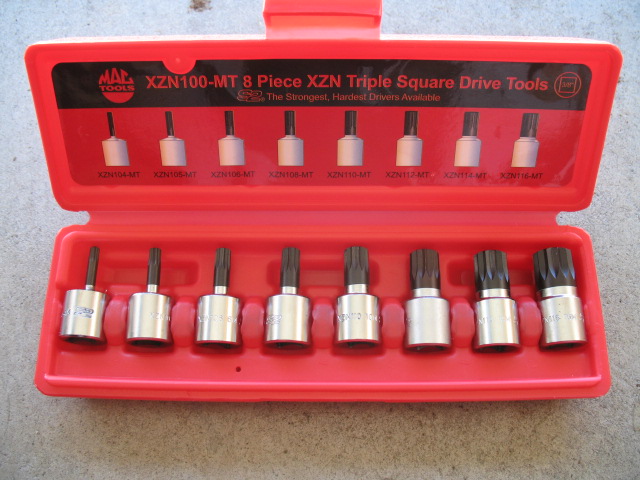

I have this same set sold by MacTools and it has saved me countless times. Highly recommended.
